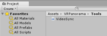

If using VR Panorama as your capture tool, the latest version includes such a script. Make sure you are working with the latest plugin update and find the script under Assets/VRPanorama/Tools/VideoSync.cs.
VideoSyncAsset

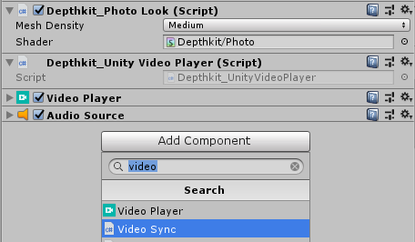

Now you just need to apply this script to each Depthkit clip.
AddVideoSync
To Note:
  • Make sure that your VR capture framerate has the same fps as your Depthkit video.
  • This script only works for the Unity video player. To use this method with AVPro, repeat the same steps with the script edited for AVPro.
