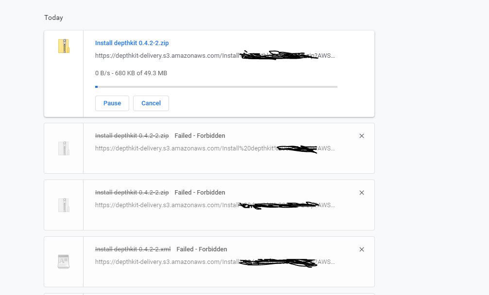

I’m a new DepthKit Pro subscriber, as my Azure Kinect’s arrived.
Sadly for the past 2 hours I’ve been trying to download the 50 mb depthkit and it’s failing miserably, everytime.
Please let AWS know this or is it hosted on a very low tier at AWS?
An alternate mirror would be helpful for payed subs.
Kind Regards.
Thank you for letting us know, Clyde! This download should only take a few moments. Our apologies for the inconvenience.

Hey @clydedesouza! There was a large AWS outtage recently that affected anyone that used AWS in our region, so it was unfortunate that you happened to try downloading Depthkit at the same time. Everything should be working fine though now, let us know if you have any other issues!

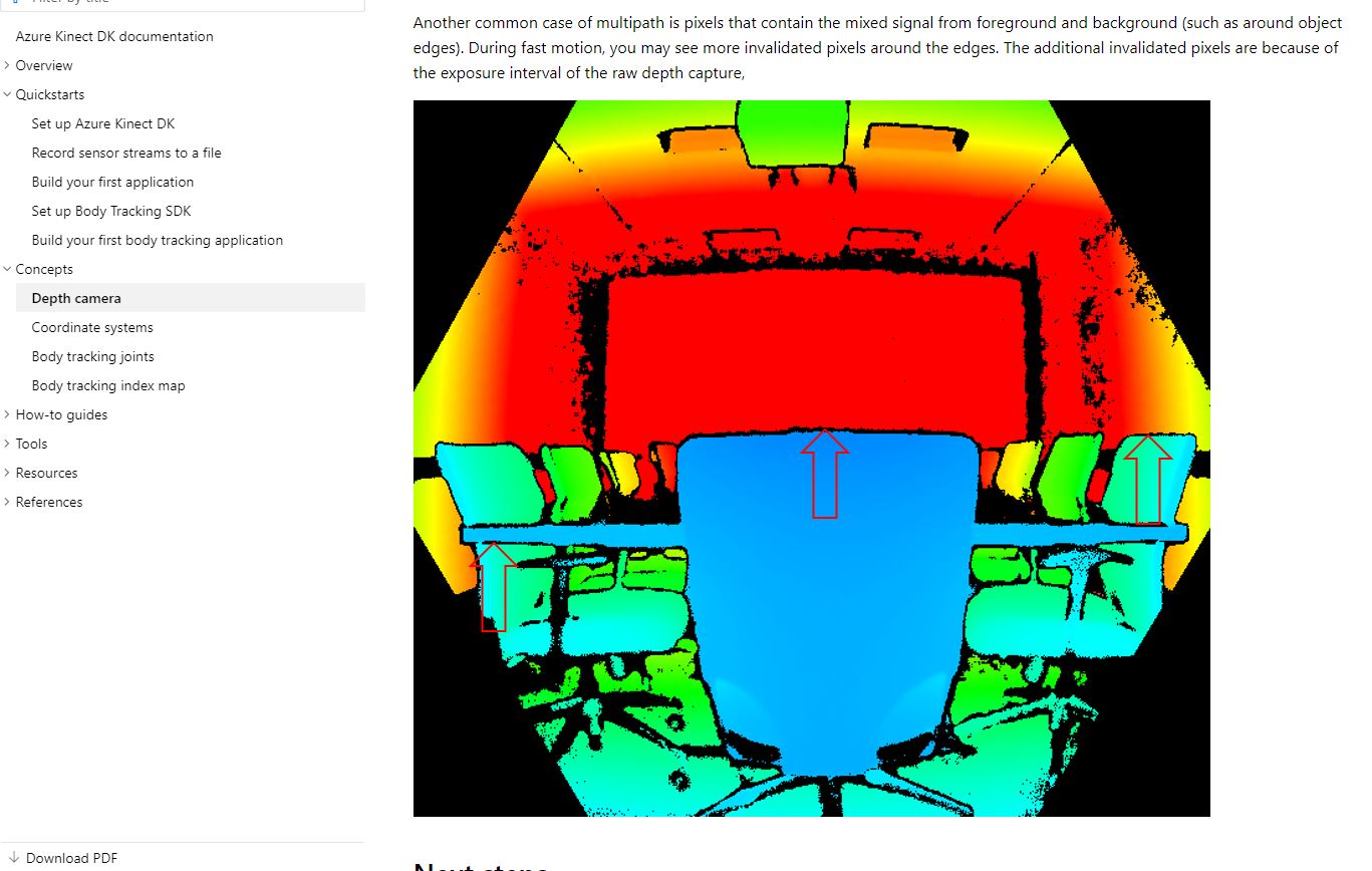

Meanwhile, to the original “border edges” issue, I’ve found out from Azure Kinect’s own site, that the problem stems from invalidated pixels caused by exposure interval in the raw capture.
What they don’t tell you, is how to fix/mitigate this. Which, in essence severely cripples the use of any environment capture with the Kinect. (the resulting video will have ghastly edges at wrong depth)
Image attached from Kinect website
invalidatedPixels
