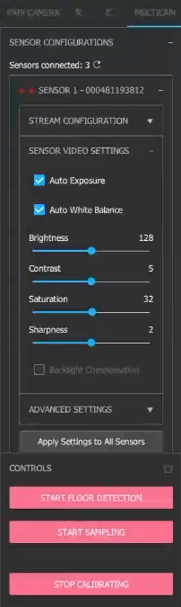

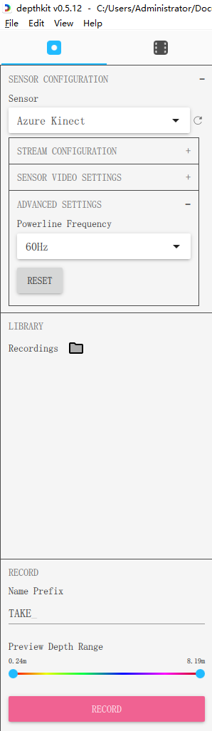

After the version upgrade of Depthkit, I can’t find the calibration button, can you tell me where to click the calibration button in the new version of Depthkit? The first picture below is the display content of the open project after the Depthkit version

@weibinliu It looks like your Depthkit Studio license has expired. In order to create Depthkit Studio calibrations, recordings, and exports, you will need to reactivate it - Please email support@depthkit.tv to do so.
