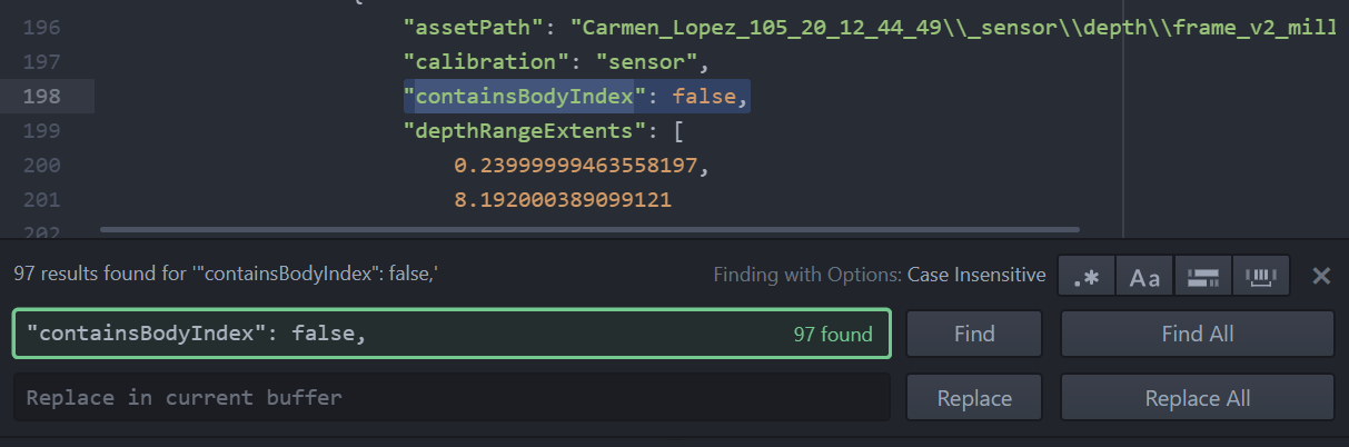

@Francisco_Julian_Mar Thank you for sending the project. Our team took a look at your project, and found a way to get your footage to appear even with Refinement enabled. To repair your project:
  • With Depthkit closed, open the project’s dkproject.json in an editor like Atom, Sublime Text, or Notepad.
  • Press Ctrl + F and search for "containsBodyIndex": false,
  • Replace every instance with "containsBodyIndex": true,
  • Save the JSON.
  • Re-open Depthkit. Your clips should appear when Refinement is enabled.
We’re still not exactly sure what caused this. Do you have any corrupted_dkproject.json files? If you do, please send it to us, as they may provide some clues.
