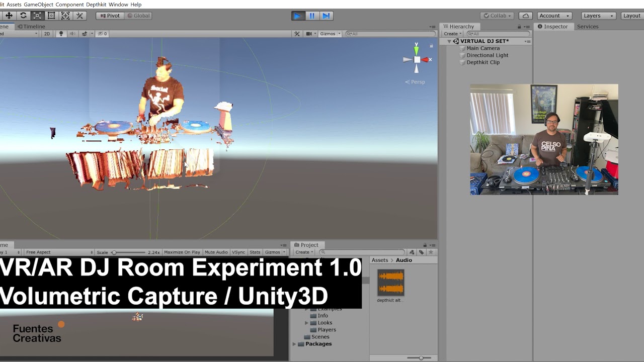

Wheeeew! Thats great news. I have Adobe Premiere so I’ll give that a go this weekend! I did clap as a point of reference! Here’s a quick screen grab video I made during the process! I sync’d my audio with this screen video just to get inspired. Can’t wait to actually sync it all up and take the next step! Thank you!

This is cool! Is the idea that someone could potentially have a hologram DJ performing music for them in their space? Love it.
