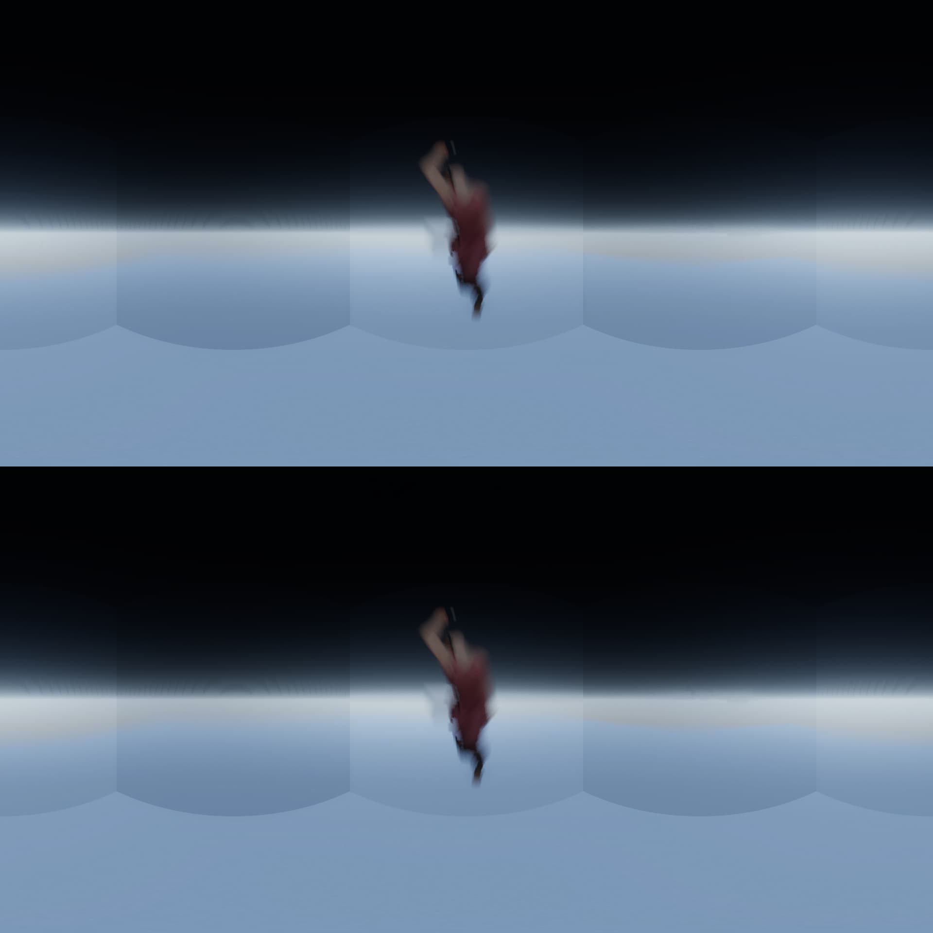

My goal is to create a 360 PNG sequence from Unity 2020.3.33 HDRP, and after following all the steps in the new workflow, I have trouble with exporting.
Last week I did export some PNG frames which were blurry as I was still getting familiar with the whole setup, and this week I seem to be having no luck.

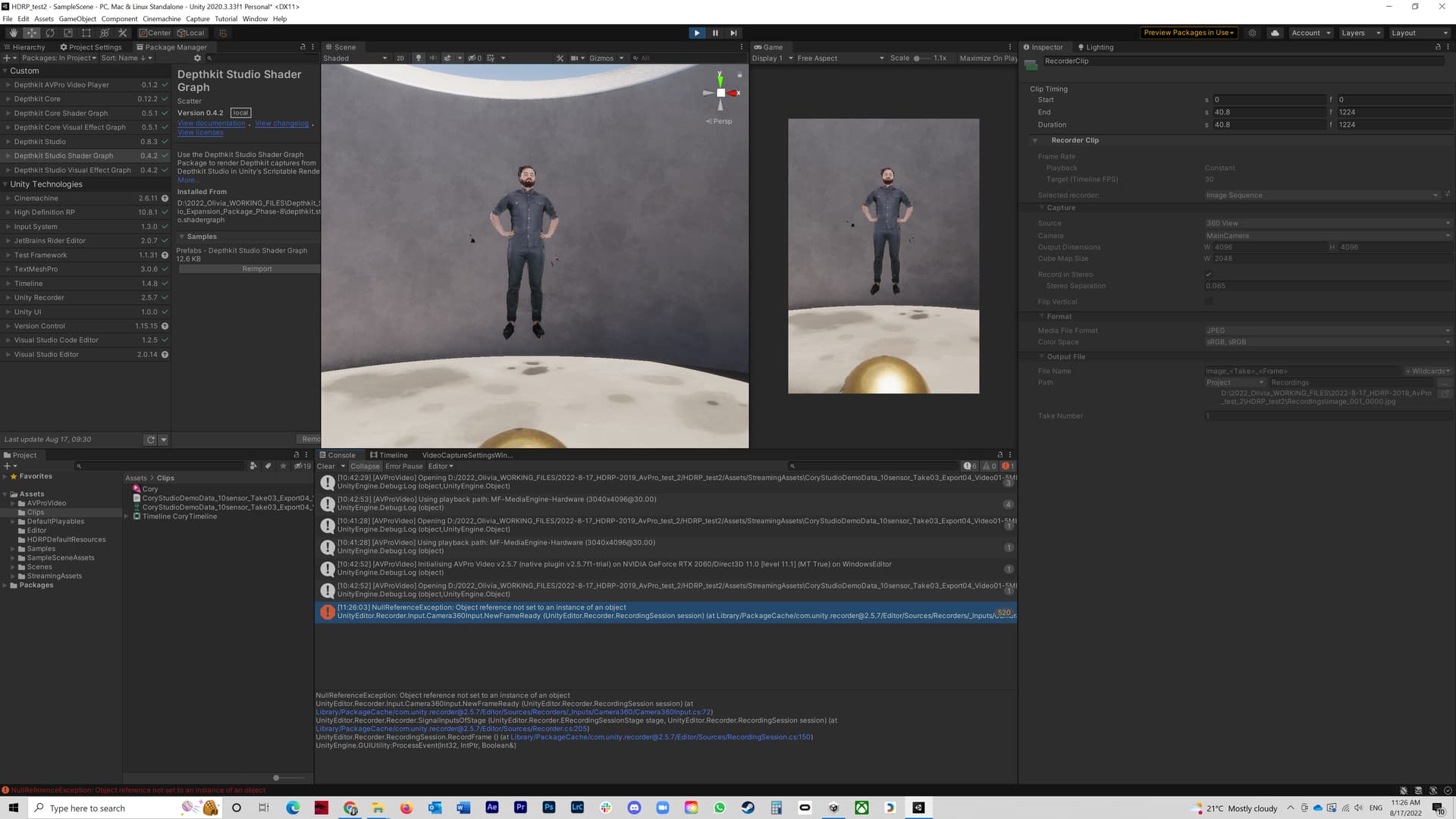

Console error (last screenshot):
NullReferenceException: Object reference not set to an instance of an object
UnityEditor.Recorder.Input.Camera360Input.NewFrameReady

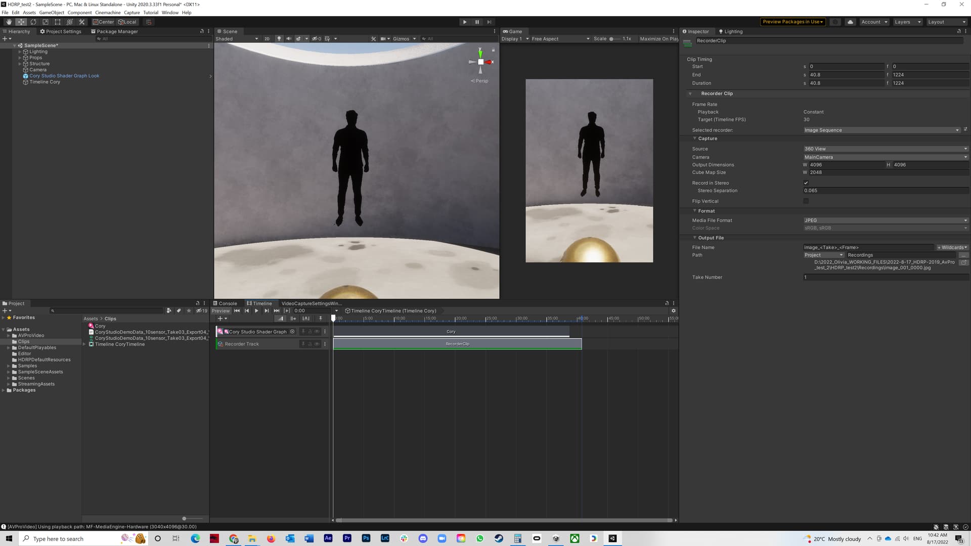

The timeline is setup the same way and all the settings are the same but I am not getting any PNG or JPG after the timeline seems to run it’s course after pressing play. I tried the Recorder’s Movie option which does work.

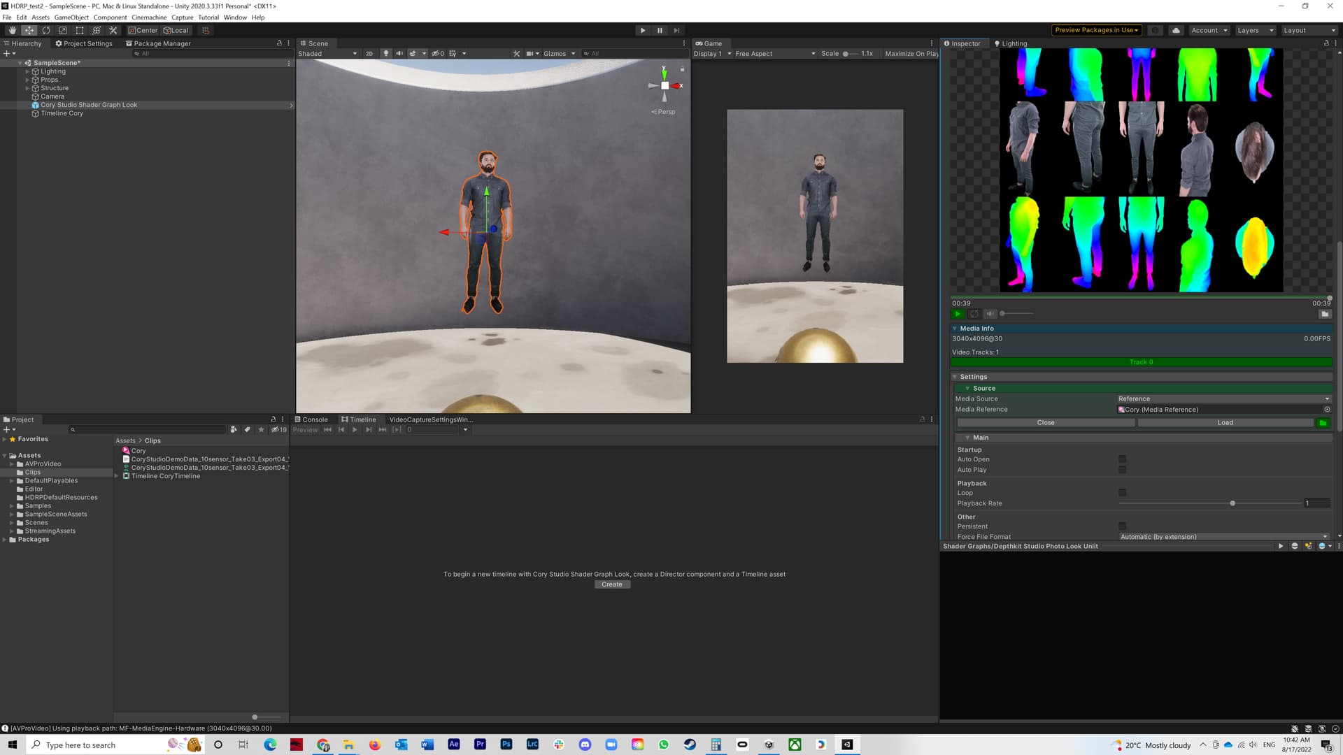

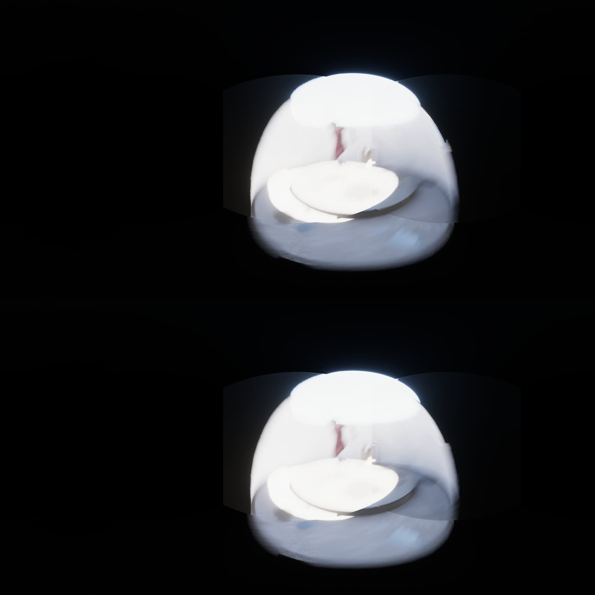

The first two screenshots are from my test HDRP 2020 project with my 7min capture loaded and playing from the media player: one PNG frame from the Unity sample scene, one PNG frame from the AVPro Demo360 Sample scene.
The second batch of screenshots are from a new HDRP 2020 project using the sample 10 sensor Cory capture to see if that would help me identify anything I was missing. Thanks for your help with this, I am really hoping to get it working.
