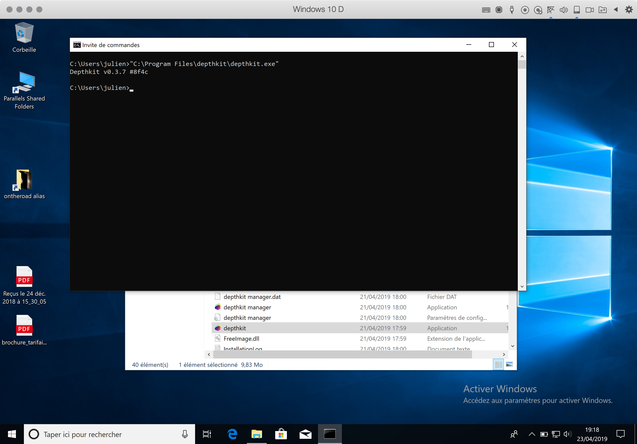

kkukshtel Kyle Kukshtel Staff #5
Ah sorry I didn’t realize you wanted to do that exclusively. Virtualization software isn’t a 1-to-1 mapping of the environment it’s emulating so there could be a lot of things preventing this from working. To better figure out what’s going on, can you launch Depthkit from the command line (cd’ing to the directory and running depthkit.exe) and then sending us the terminal output?
I suspect it has to do with how Parallels handles graphics in that it isn’t meant for graphics-heavy applications. As @jillianmorrow said, Bootcamp will be your best bet here.
