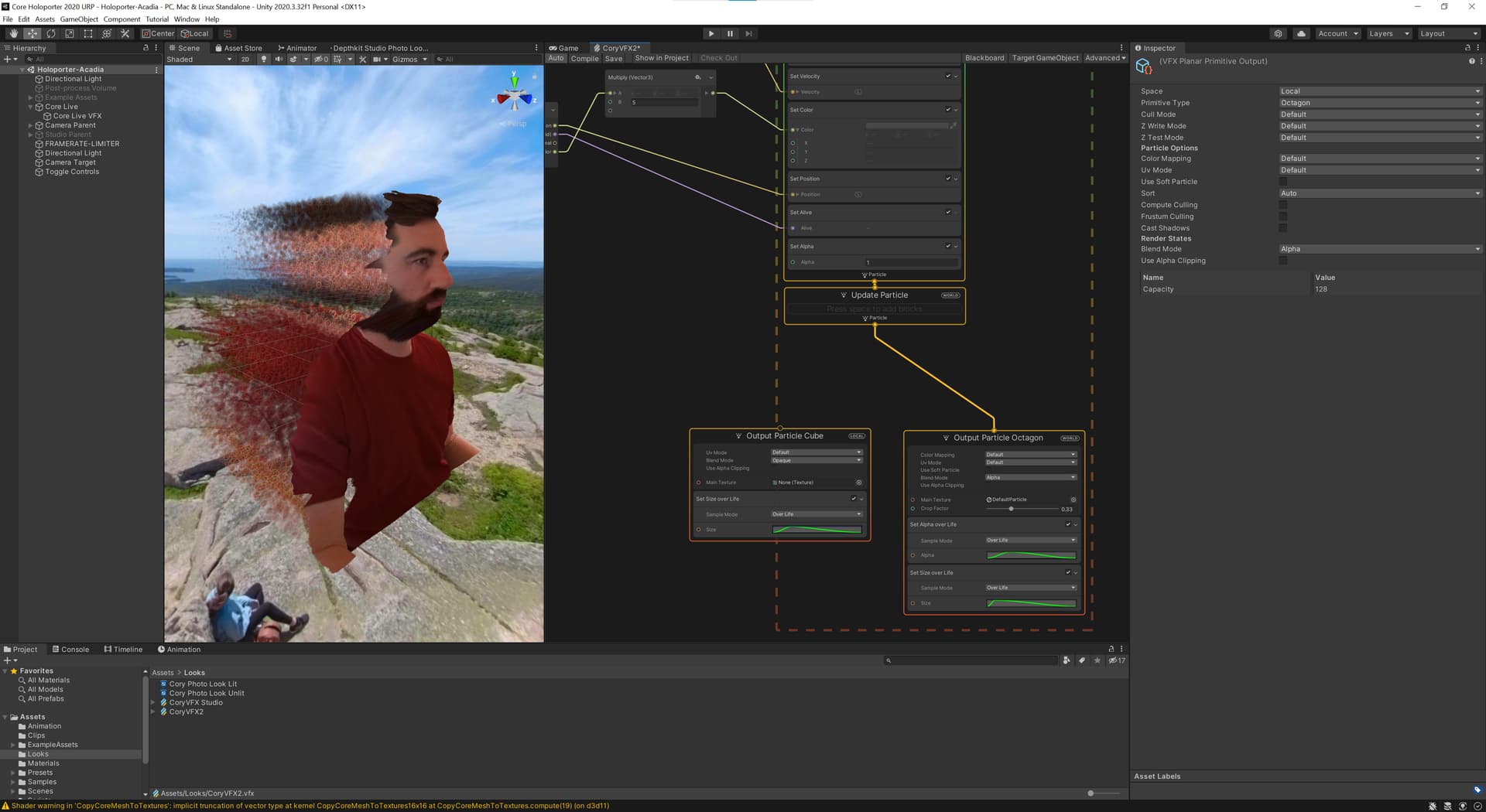

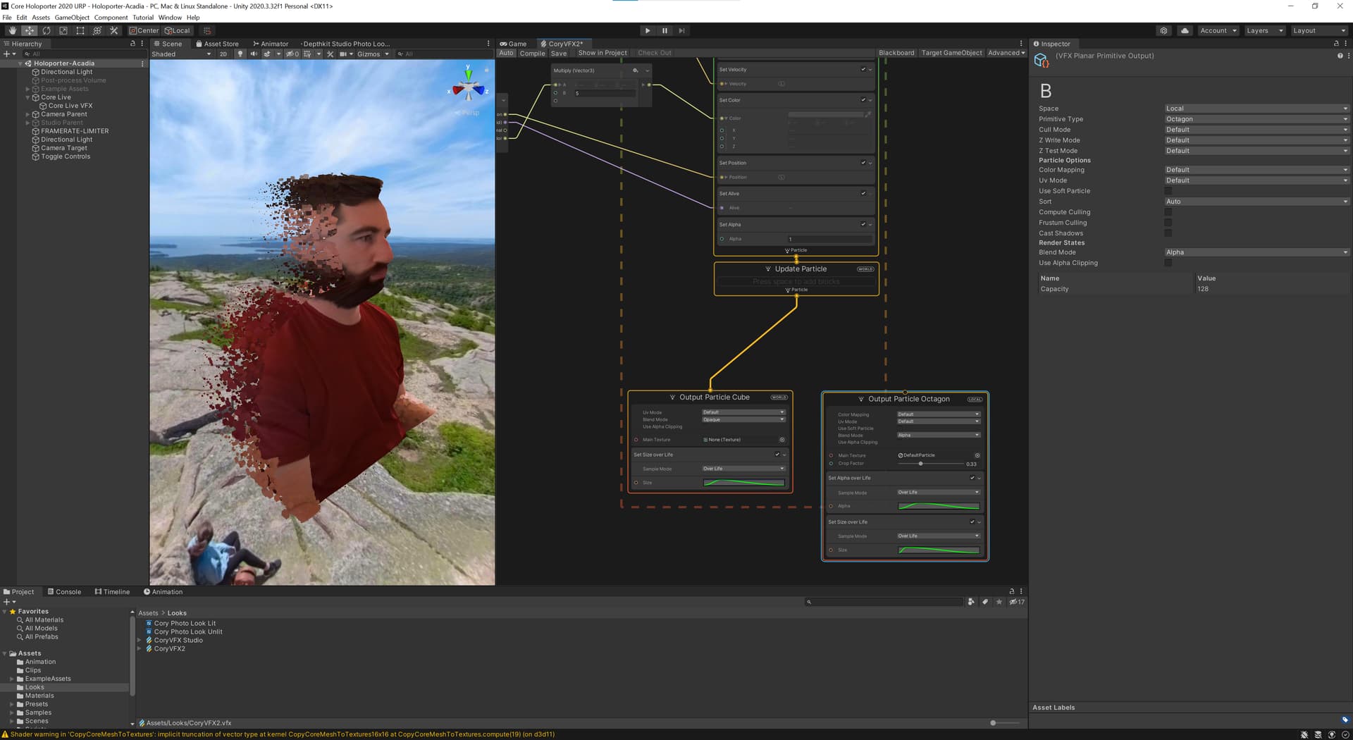

Hi, @TimoWright - It looks like you have the edge masking/dithering tools of your photo look set nicely. I think to get the aesthetic you’re after, you’ll need to edit the VFX Look which is linked to your Depthkit object. Here are two variations on the look that I use for my livestreaming setup, one with cubes, and one with octagons which reduce their alpha over time. Take not of which node is connected in the VFX graph:
Quick note: I have modified the velocity of the particles in my look to all move in a uniform direction, rather that one that is driven by the normal direction where it spawns.
Let me know if this helps, or if you’re looking for something else.

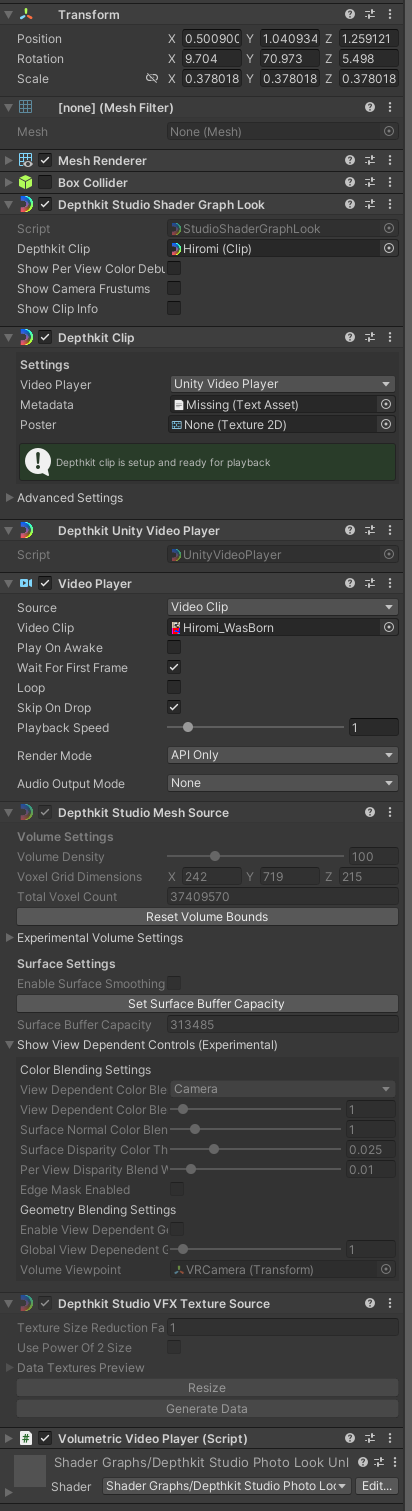

@TimoWright One other thing: Our team noticed that you’re using the Studio Mesh Source (meant for multi-sensor assets), but for single-sensor assets, you’ll likely find the Core plugins and tools to be more effective.
