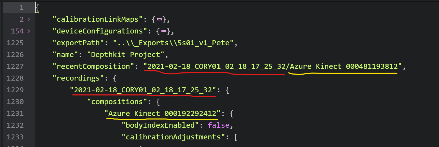

@JasonGray ,
I suspect Depthkit is crashing because the recentComposition object in the dkproject.json is referencing a folder which no longer exists. See attached screenshot to see how the recentComposition object is formatted:
There are two approaches you can try:
  • Rename the recording folders back to their original names. You can find these names in the JSON under the “recordings” object.
  • Backup your JSON, then perform a Find and Replace and change the original names of the recordings to what you renamed the folders. Only change the recording name (underlined in red), not the composition name nested within it (underlined in yellow). Then update the recentComposition object with a value that represents the newly-renamed recording.
If these don’t get your project working, let me know and I’ll jump on a call to guide you through it.
