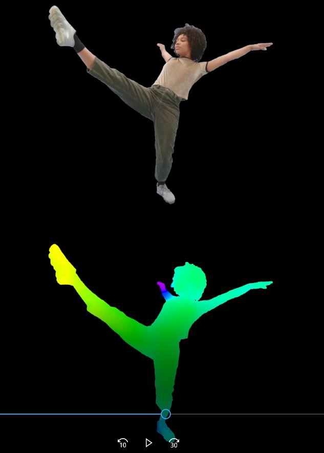

I did read a lot on both Unity integration and AE importing, and I might have missed something, but I couldn’t find any workflow on manipulating DepthKit’s Video format in AE to gain some semblance of 2.5D effects using the AE camera.
Are we locked to manipulating obj sequences only for VFX in AE?
I imagine this could be quite a feat for say a 30 second long narrative dialog.
One thought I had is - Could there be a parser or gradient map method of converting the color depth map from Depthkits video to Grayscale?
This would then work with AEs Displacement Map effect and really open up the workflow for us.
Do let me know if this is possible or there already is a better method, i’ve missed out on.

Getting back, yes my concern is with importing an Obj sequence into AE that will not be a simple index captured person. It’s a Bed with person on it - so there will be some background, but it fits well with “slice of life” style for the promo in VR (and ar) as well as the aesthetic we are aiming for in the AE video VR film (perspective of a ghost watching someone on a bed)
In looking at a Depthkit - to - Grayscale and AE displacement filter, the idea was to be able to give some dimensionality to the bed / person on it.
tweaking the displacement value of the built-in AE displacement map filter, to generate left/right comp view for stereo,
I can also imagine such a workflow would be great even for 2D filmmaking where subtle AE Camera movement would reveal/expose the dimensionality of a Depthkit capture which otherwise (unless imported as OBJ seq) is pretty pointless (no pun!) for VFX work in AE.
I’m worried about the huge filesizes that may occur when importing a 30 sec Obj seq such as that of a bed and part of the background roon -
Granted, everthing is still in planning stage right now for the shot, and I’ve not tested AE’s workflow for obj seq import in either Element 3D, or Plexus or Trapcode etc…
Maybe one of these has a robust way of handling things at render time.
Having a way to convert Depthkit gradient to standard grayscale depth map and then into AE’s displacement effect filter would allow smooth complex workflows in 2.5 D.
