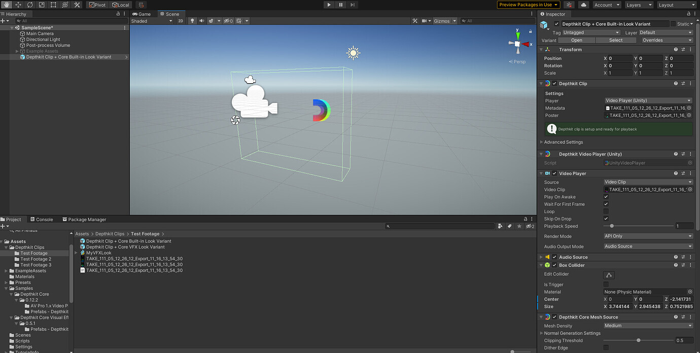

Starting a new topic for this question - I’m having some issues seeing the depthkit clip using the Depthkit Core Built-in Look. My project is set to URP, and i’m using the 2020 version. The clip renders when I use the Depthkit VFX prefab, but when I try to use the Depthkit Core Built-in Look, I just see the depthkit logo.
@StevenReneau The Built-in Look only works in the Built-in Render Pipeline - To get the asset to render with a photo look in URP, use the Shader Graph Look.
