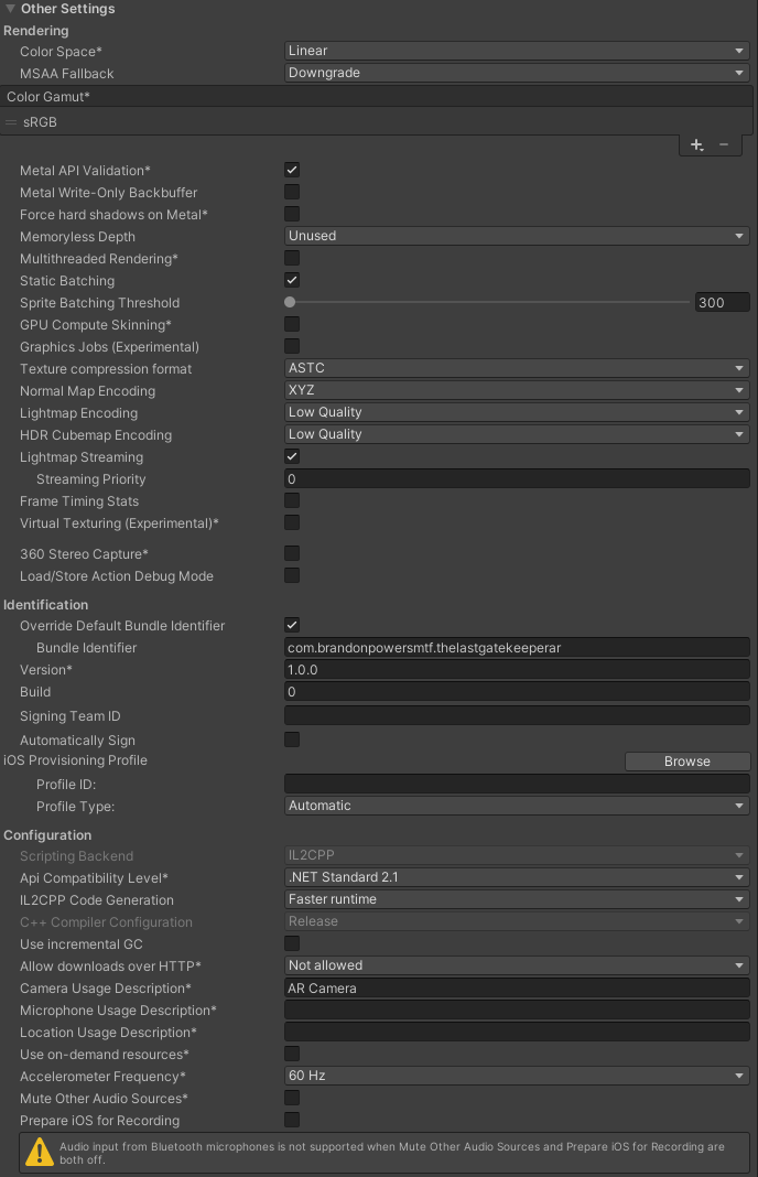

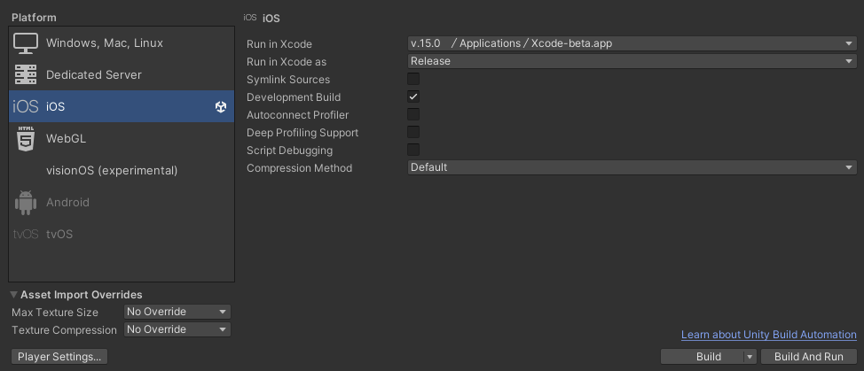

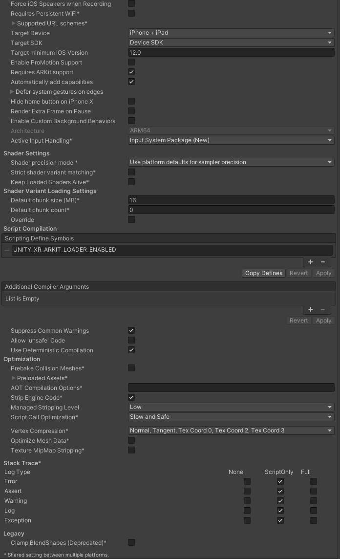

@WhittSellers Thanks for the additional information you provided in the other thread.
Can you confirm the build and player settings you have set for this project? I’ll see if I can reproduce the issue.

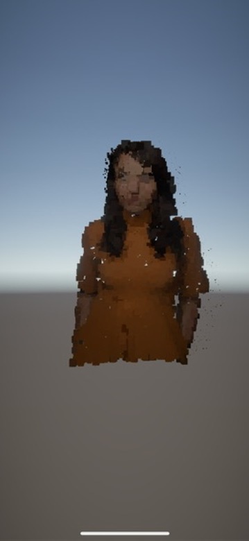

@WhittSellers - Not exactly matching your configuration, but I set up an empty Unity scene including a Depthkit Core asset with VFX look applied, and was able to run it on an iPhone.
  • Unity version: 2022.3.25f1
  • Depthkit SDK Version: Phase 10
  • Xcode version: 15.4 (15F31d)
  • Device: iPhone 15 Pro (A17 Pro)
  • iOS version: 17.5.1
Edit: Also worth mentioning that this is the default VFX look configuration with a particle spawn rate of 10,000 and a capacity of 1,000,000

@WhittSellers I was able to match your build and player settings exactly and render both a Shader Graph and VFX look on the phone (though I am having trouble setting up the AR camera render layer 😅). The only difference I can spot is the Xcode version you’re running: 15.0, while I am running Xcode 15.4. Is there another constraint that’s preventing you from updating?
