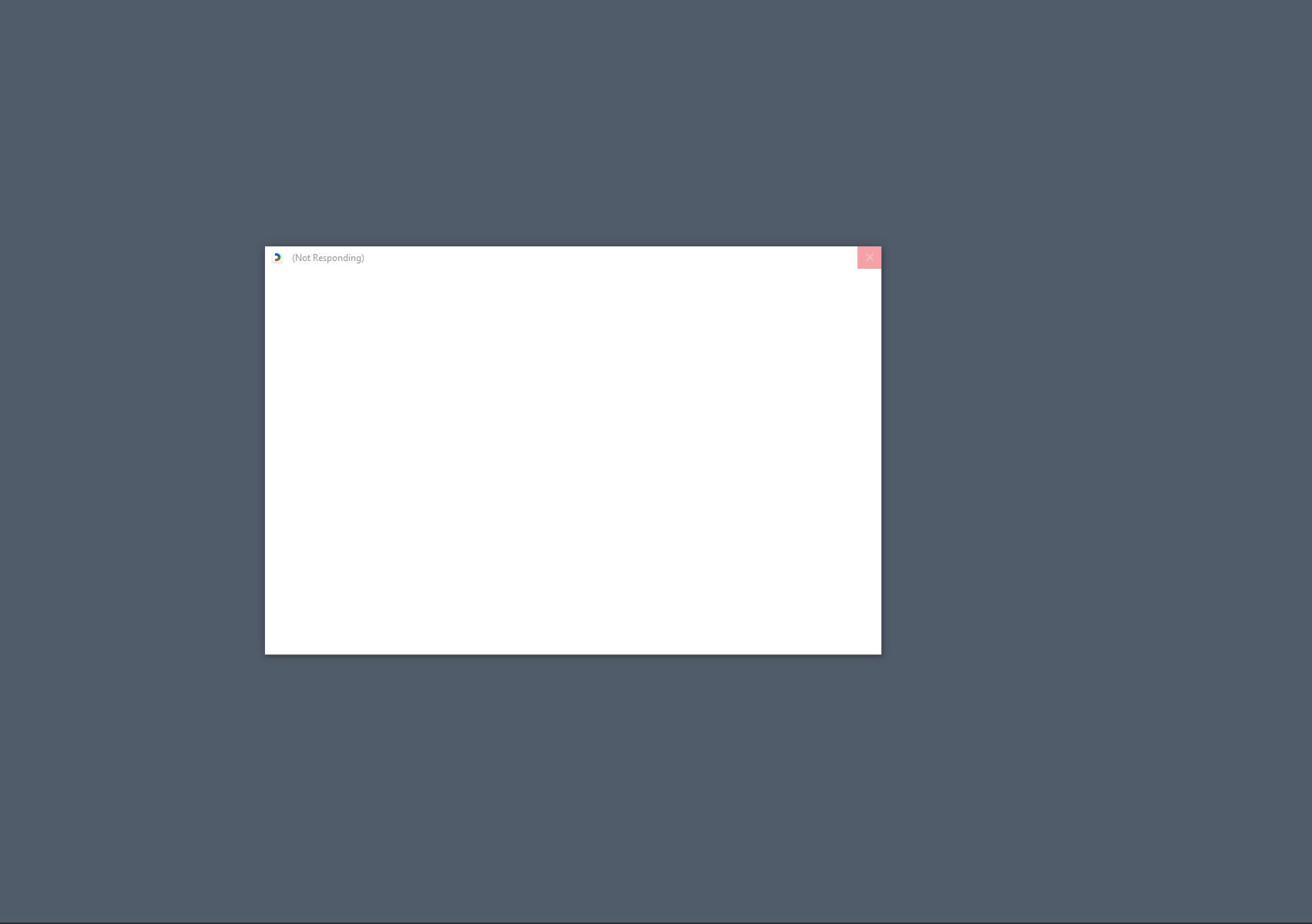

I’m having an issue when Depthkit crashes after I attempt to launch a project. I receive an error (see attached), followed by a blank white window with “not responding” and the program exits about 2 seconds after the white screen.
The issue appeared after renaming a “take” folder via Windows Explorer.
@JasonGray Renaming a take folder will break the project, since the path that the project JSON points to no longer exists. With some care, you can change both the take folder names, as well as all instances of that name in the dkproject.json, but be sure to backup the JSON before trying this.
