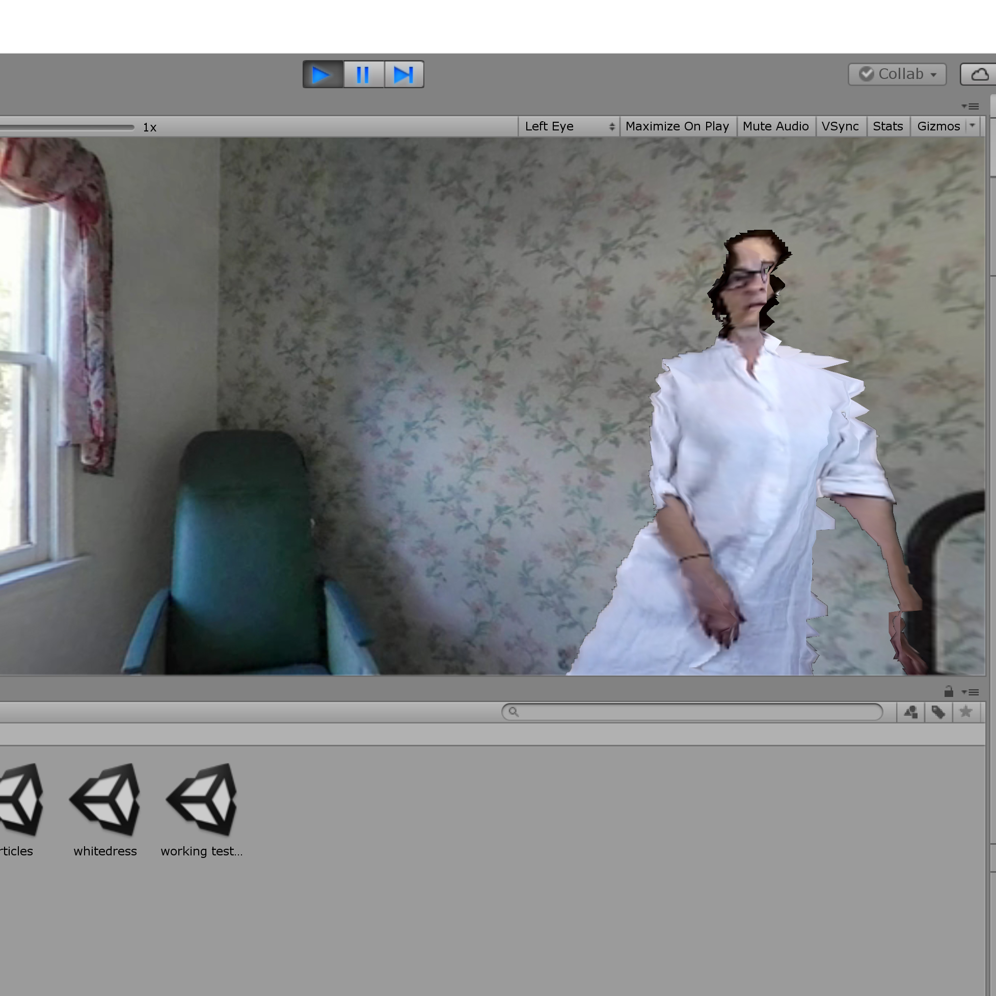

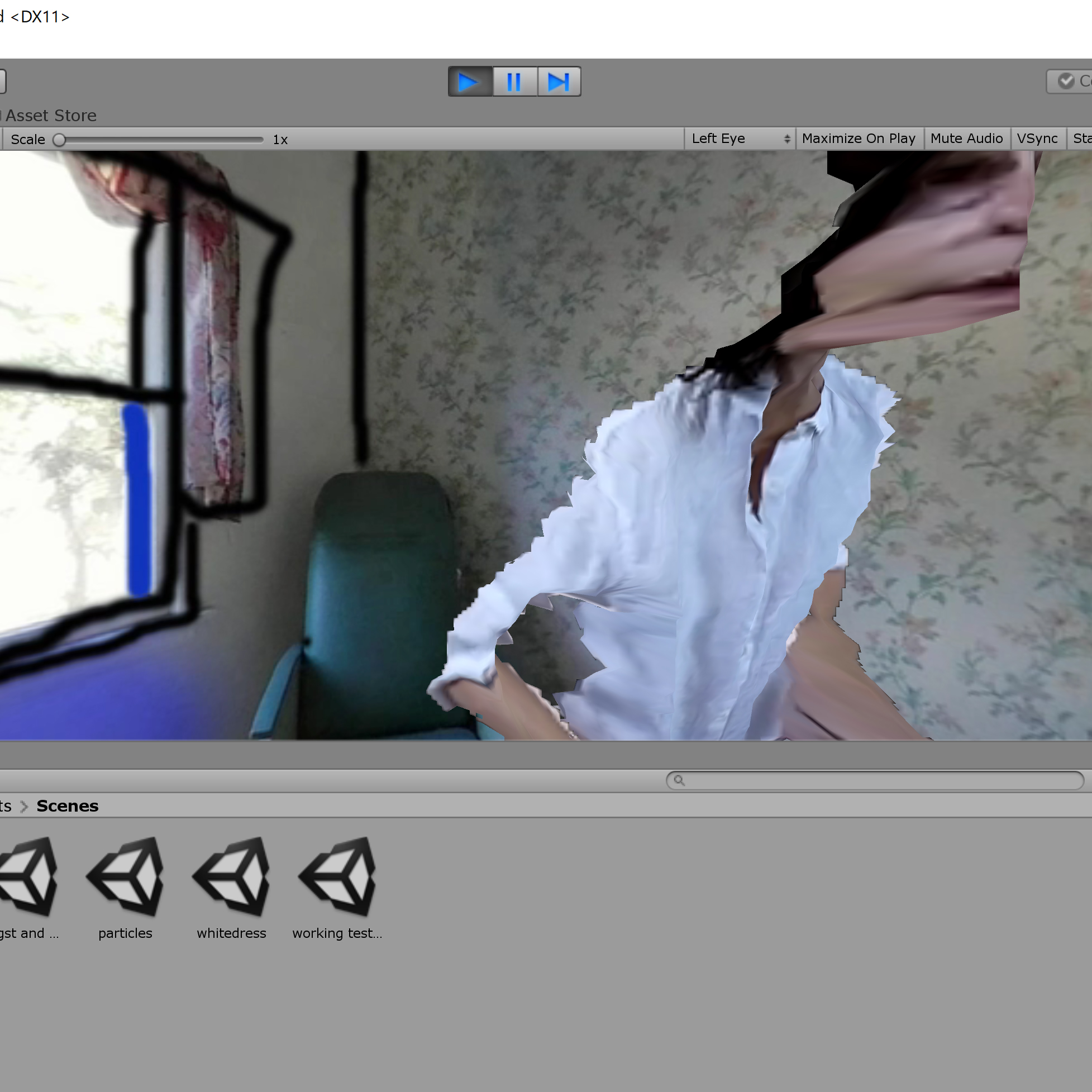

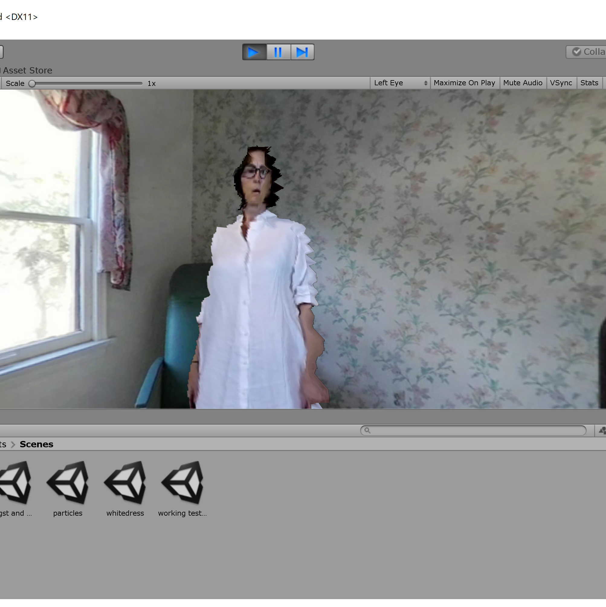

I have three jpgs attached. Once I brought the depthlkit file into Unity and started re-positioning, it got really distorted.
distort3.jpg shows the image closest to what I captured but the edges got jagged. (I’m getting nice results with Pro prior to bringing into Unity!)
You can see in distort2.jpg how the image loses smooth edges completely and almost folds in on itself. In distort1.jpg I’m losing part of the figure
which I don’t want to happen.

Hey Elizabeth, thanks for sharing these images. This looks like it may due to some color space conversions in Unity. Are you using the Unity video player in your Depthkit clip? If so, I recommend trying AVPro. In case this doesn’t solve the issue, I recommend just downloading a trial of AVpro just to test. If that doesn’t fix the issue, let me know!
See details in our troubleshooting section of the Unity plugin.
