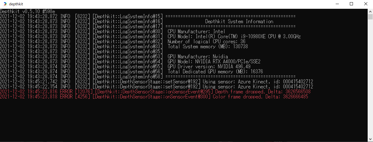

@KiralPoon The console reports all dropped frame events, even when Depthkit is not recording, so you can ignore these warnings.

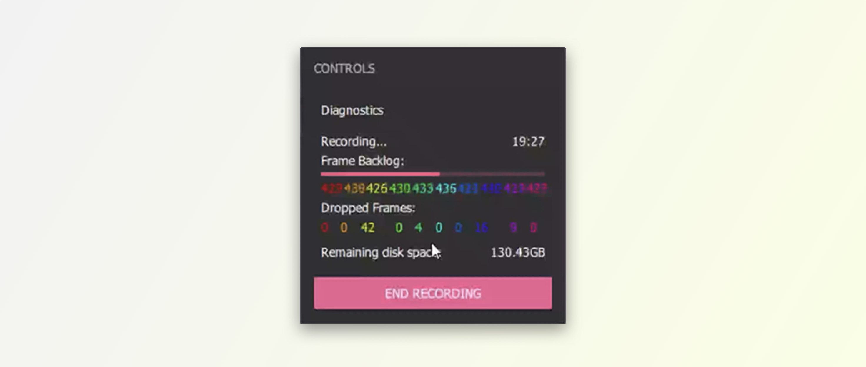

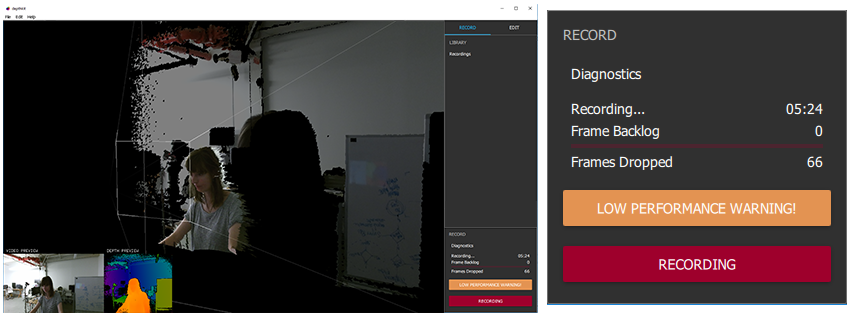

When you are recording, check the ‘Diagnostics’ panel which appears above the record button to see if any frames are dropped.
If you are recording with multiple sensors, the ‘Diagnostics’ panel looks like this.
If there are dropped frames being reported here, you can follow the recommendations in our Performance Testing documentation and Depthkit Studio Recording documentation.
