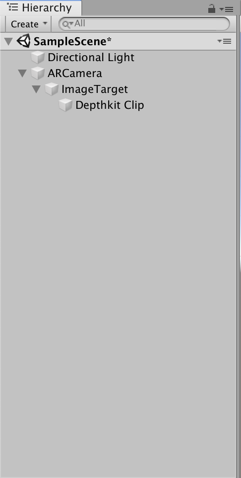

In my case, at the beginning I added the ARCamera then added the image target then added the DepthKit object to the image target.

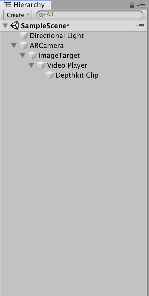

This is how the hierarchy looked like:
Now this would perfectly work if you run the scene on Unity. However once we built this project for iOS and then built the iOS app on Xcode then run the app on your iOS device, the DepthKit Object would show up in the app but the object wouldn’t move (animation/video doesn’t work).
There is a quick fix for this. Instead of adding the DepthKit object directly to the image target, add a video player to the image target then add the DepthKit Object to the video player.
