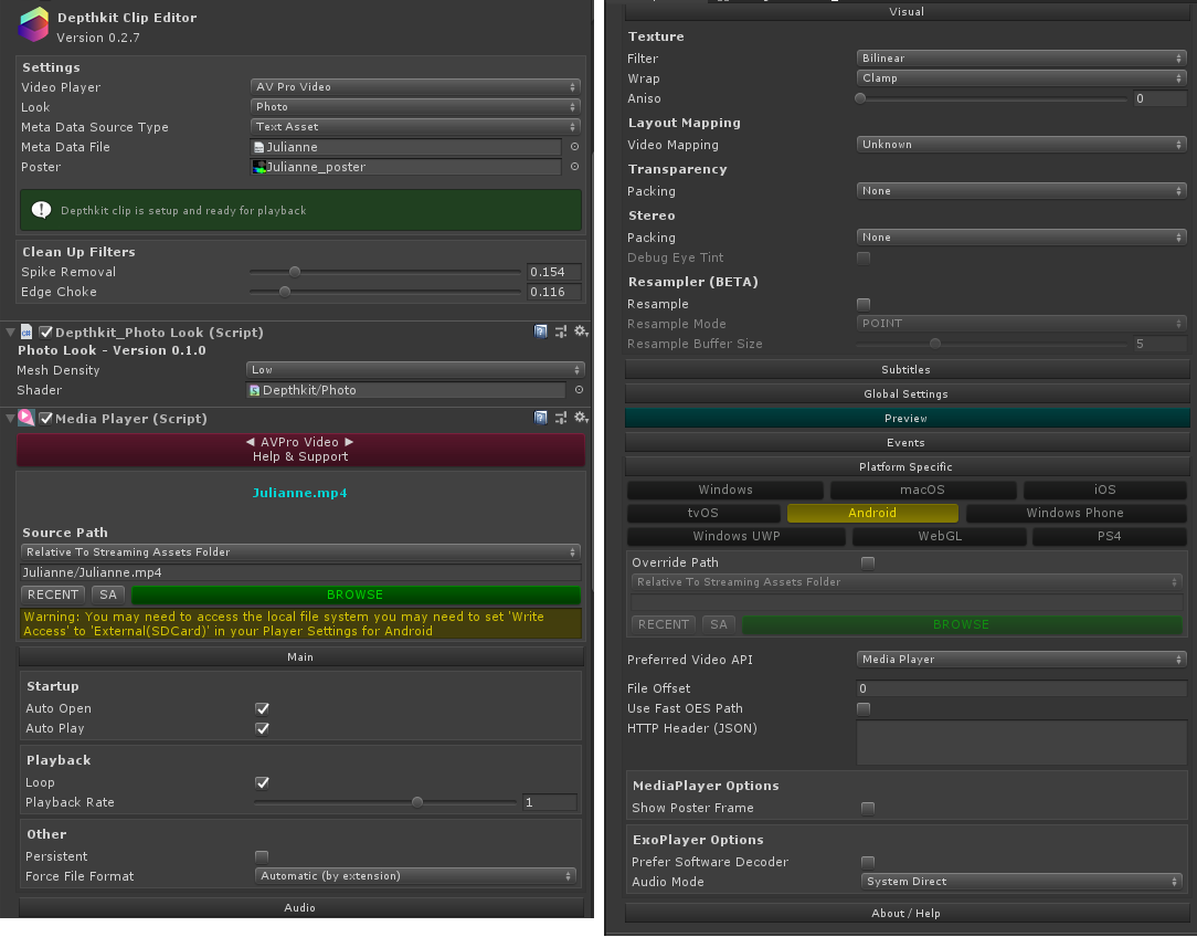

I’m trying to test out DepthKit in a Unity build for Oculus Quest, but I experience poor framerate when putting only an OVRCameraRig from the OVR Plugin along with a sample clip (Julianne).
I set the settings to low on Julianne, but I instantly drop to 50fps when looking at the clip in the Quest build.
Am I doing something wrong ? I’ve seen that it should be working smoothly with a single clip.

I downloaded AVPro trial version for I was indeed using the default Unity VideoPlayer, but it drains even more performances. I tried multiple settings, but here are the current ones :
Basically, my build runs at approx. 50-55 fps using everything by default, and approx 45 using AVPro + I usually have spikes artifacts.
