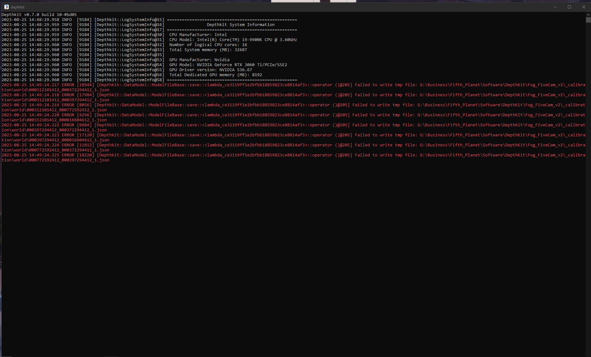

Hello - when I try to open one of our old 5 camera projects with the latest Depthkit software, I get some console errors about JSONs and it closes. Here’s the console:
Any guidance would be greatly appreciated. Thank you!
Hi, @JesseKirberger - It looks like the Depthkit directory you’re working in might be read-only, since the errors in the console indicate that Depthkit is failing to write temporary files. Can you check the permissions of the volume, or move the project to a different volume with write access and open it from there?
