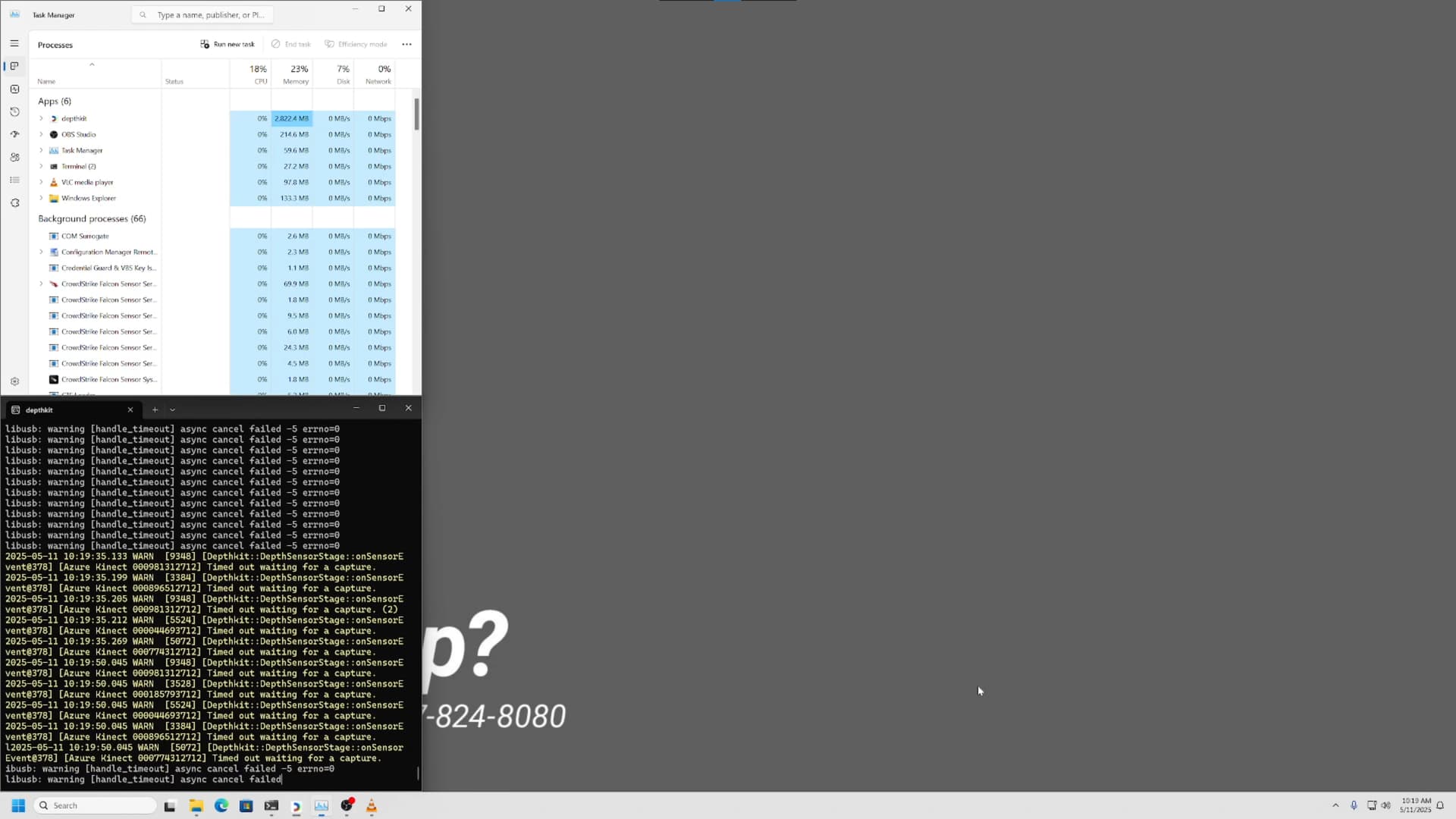

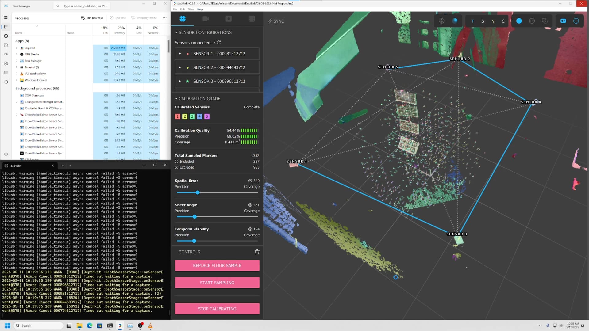

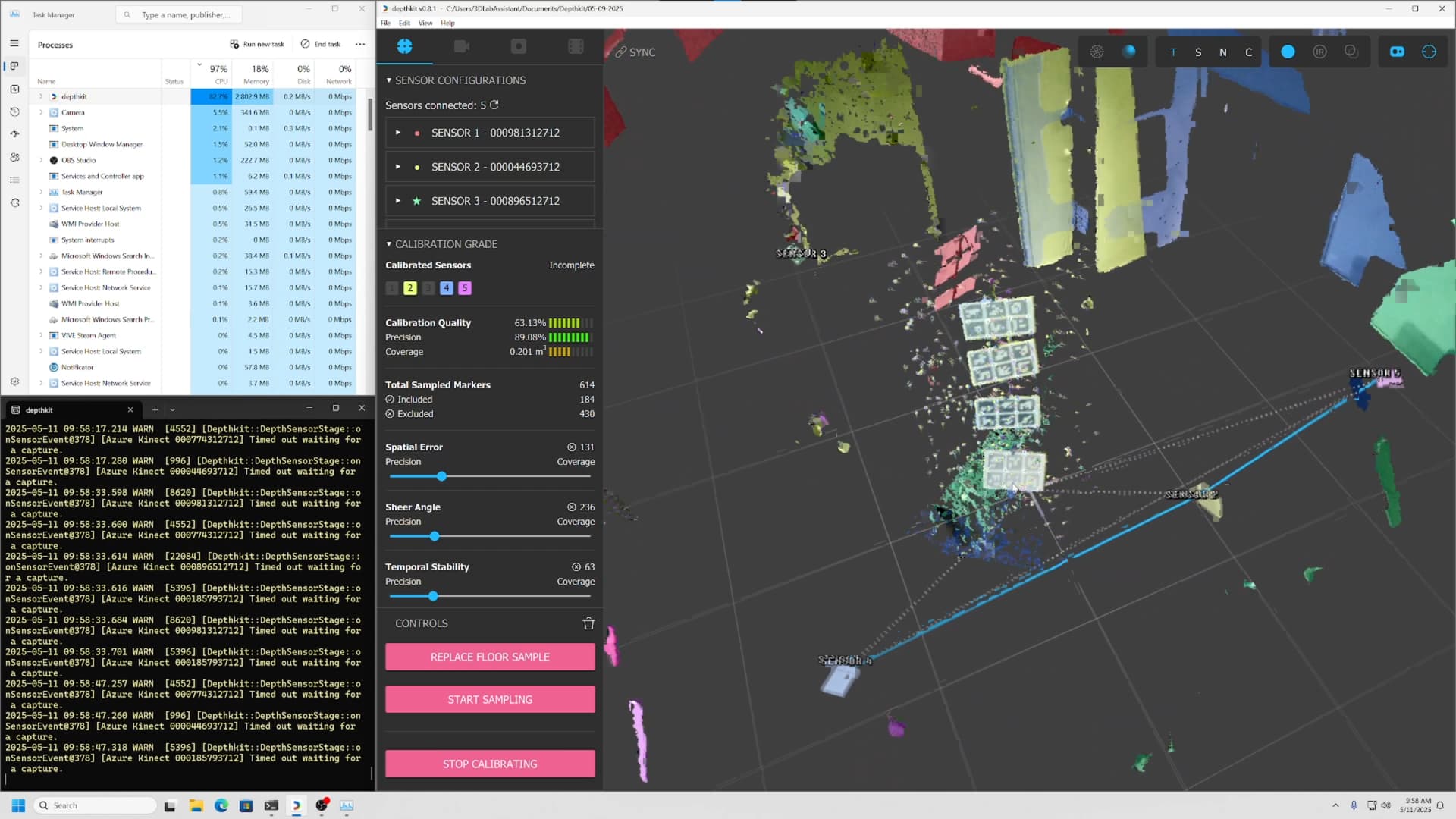

Please let me know if you would like this to be a separate thread, here is what I have encountered so far with a test yesterday:
  1. Hard Computer Freeze, I only noticed increased CPU usage and sensor timeout warnings.
  2. The Depthkit Studio application stopped responding/froze during calibration. This can also occur during recording.
libusb: warning [handle_timeout] async cancel failed -5 errno=0
WARN [9348][Depthkit::DepthkitSensorStage::onSensorEvent@378] [Azure Kinect 000981312712] Timed out waiting for a capture
WARN [3384][Depthkit::DepthkitSensorStage::onSensorEvent@378] [Azure Kinect 000896512712] Timed out waiting for a capture
WARN [9348][Depthkit::DepthkitSensorStage::onSensorEvent@378] [Azure Kinect 000981312712] Timed out waiting for a capture (2)
WARN [5524][Depthkit::DepthkitSensorStage::onSensorEvent@378][Azure Kinect 000044693712] Time out waiting for a capture.
WARN [5072][Depthkit::DepthkitSensorStage::onSensorEvent@378][Azure Kinect 000774312712] Timed out waiting for a capture.

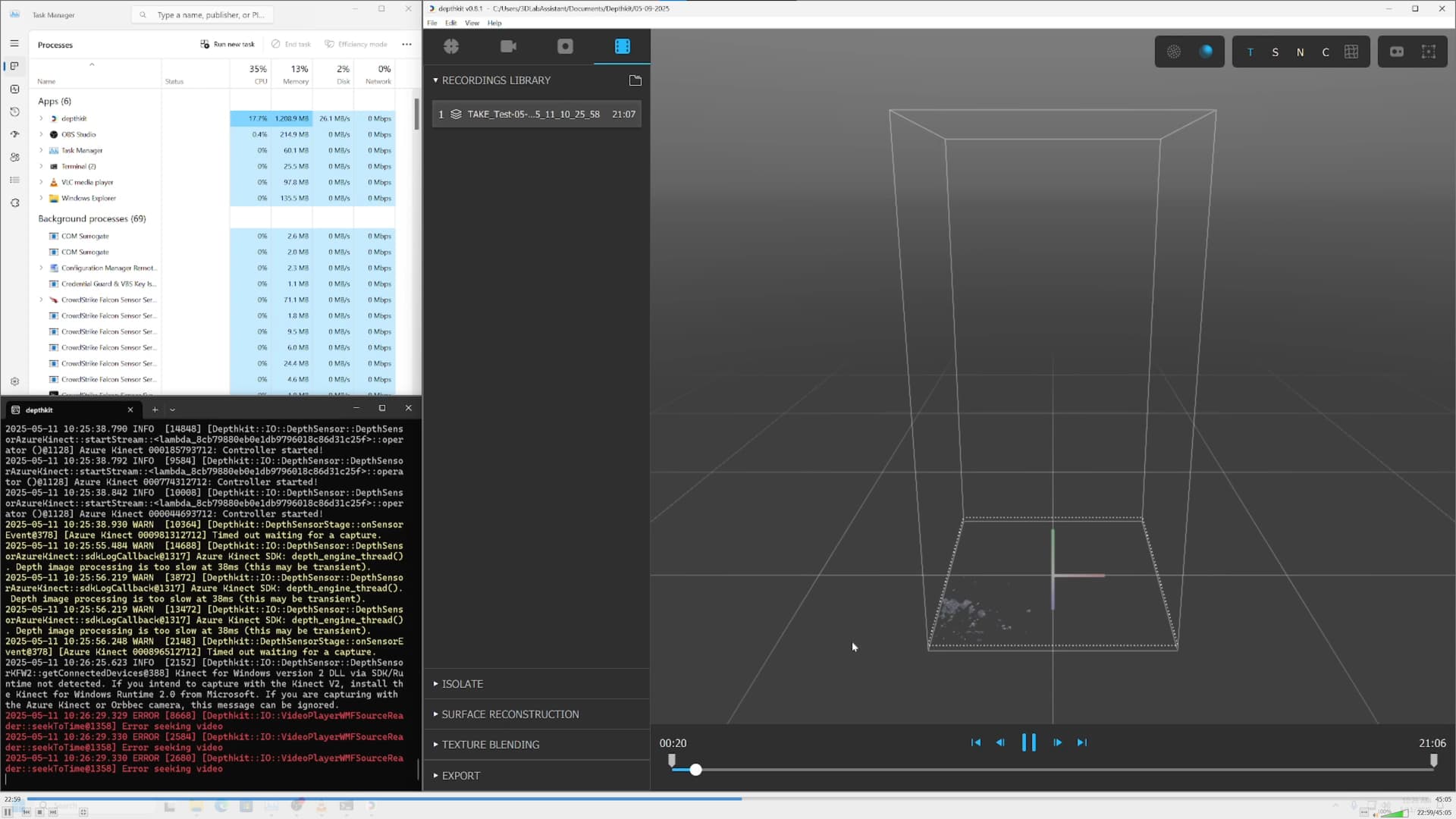

  1. This was a one off issue I encountered yesterday, depthkit Studio stopped responding during video clip playback, though the clip itself is uncorrupted and can be played back on a subsequent relaunch.
Error [8668][Depthkit::IO::VideoPlayerWMFSourceReader::seekToTime1358] Error seeking video
Error [2584][Depthkit::IO::VideoPlayerWMFSourceReader::seekToTime@1358] Error seeking video
Error [2680][Depthkit::IO::VideoPlayerWMFSourceReader::seekToTime@1358] Error seeking video

  • The CPU usage show in image 1 is much higher than we expect. Do you recall which color and depth resolutions the cameras were set to while this was occurring? The calibration process doesn’t use the data from the color cameras, so you can set them all to 720p color before starting calibration to improve performance and reduce CPU load. Similarly, you can switch the depth mode to NFOV raw - Based on the sensor positions shown in the 3D viewport, your sensors will still be able to see the calibration chart in the positions you are sampling. Then, when recording, also test different resolutions to see how that affects CPU load and system stability.
  • The issues shown in the console errors can usually be narrowed down to specific sensors (or the cables / ports / USB controllers they are connected to). If these continue, try selectively removing one sensor at a time to see if the issue goes away, and if it does, trying that sensor with different cables or USB ports until you can identify which component is causing the problem.

  • I am unable to reproduce your playback issue in the project you shared. Is there any other information you can share to help us reproduce it?
