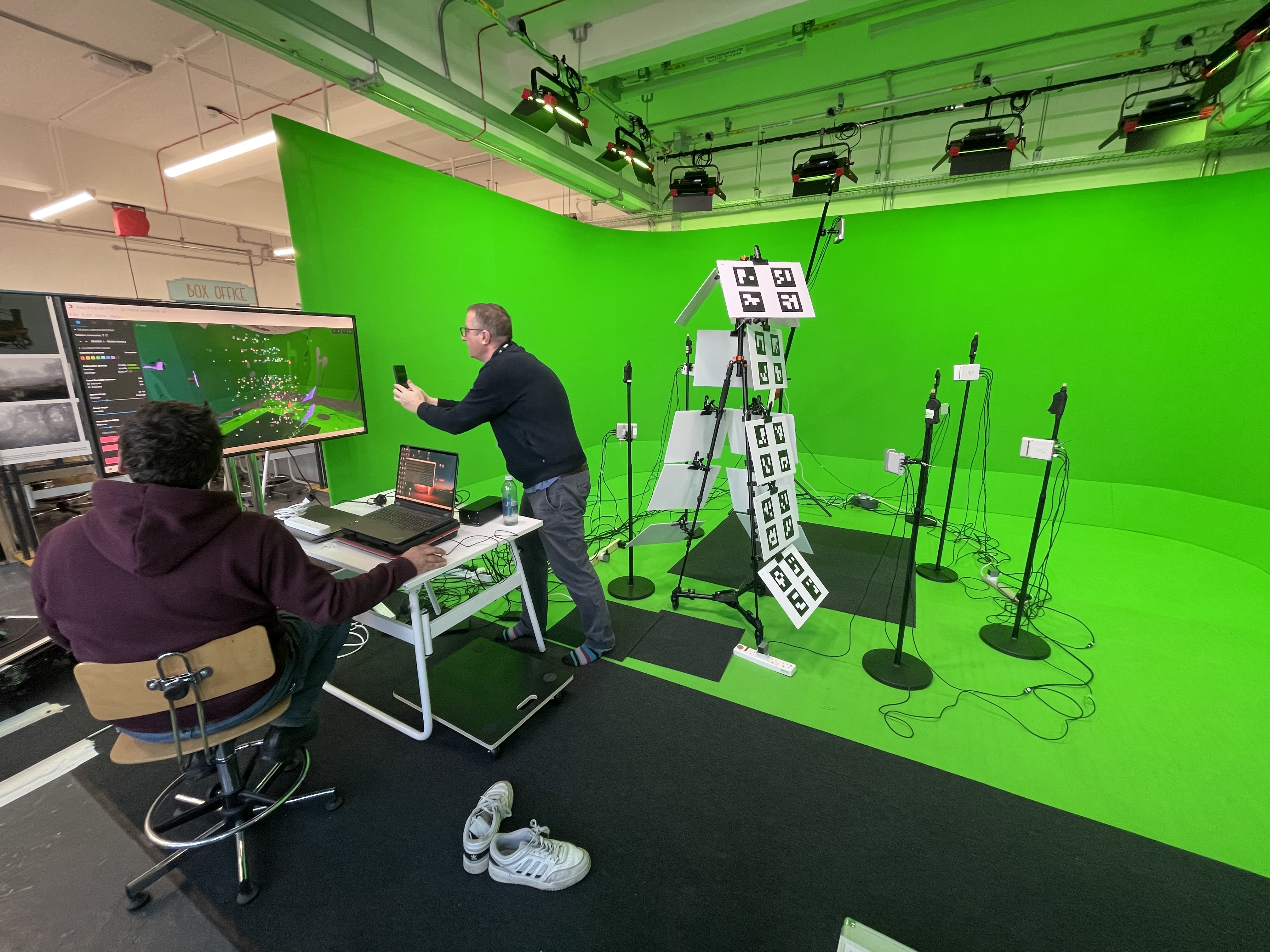

PS. The pics are of the second rig with laptop in our green screen area. But I cannot rely on this area being available for my use on (immovable) scheduled capture days. Performers are flying to London and staying overnight in hotels.

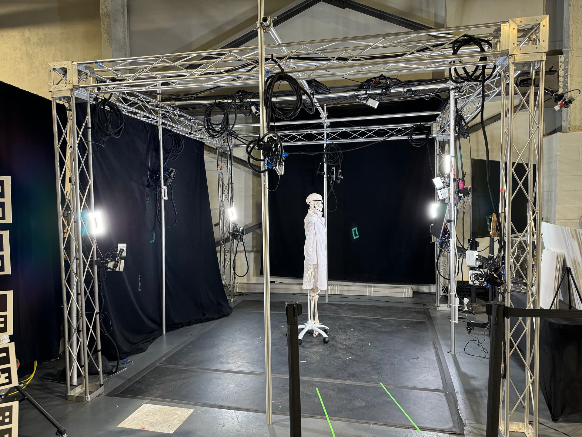

I only managed a 4.5m radius for 4 sensors aligned with the capture stage diagonals and around its perimeter. 4 sensors are closer along in the centre of each side on a 2.7m diameter. Your comments about the two overhead sensors noted. I have alerted the artists that they must stay within a 1.5m diameter circle.
