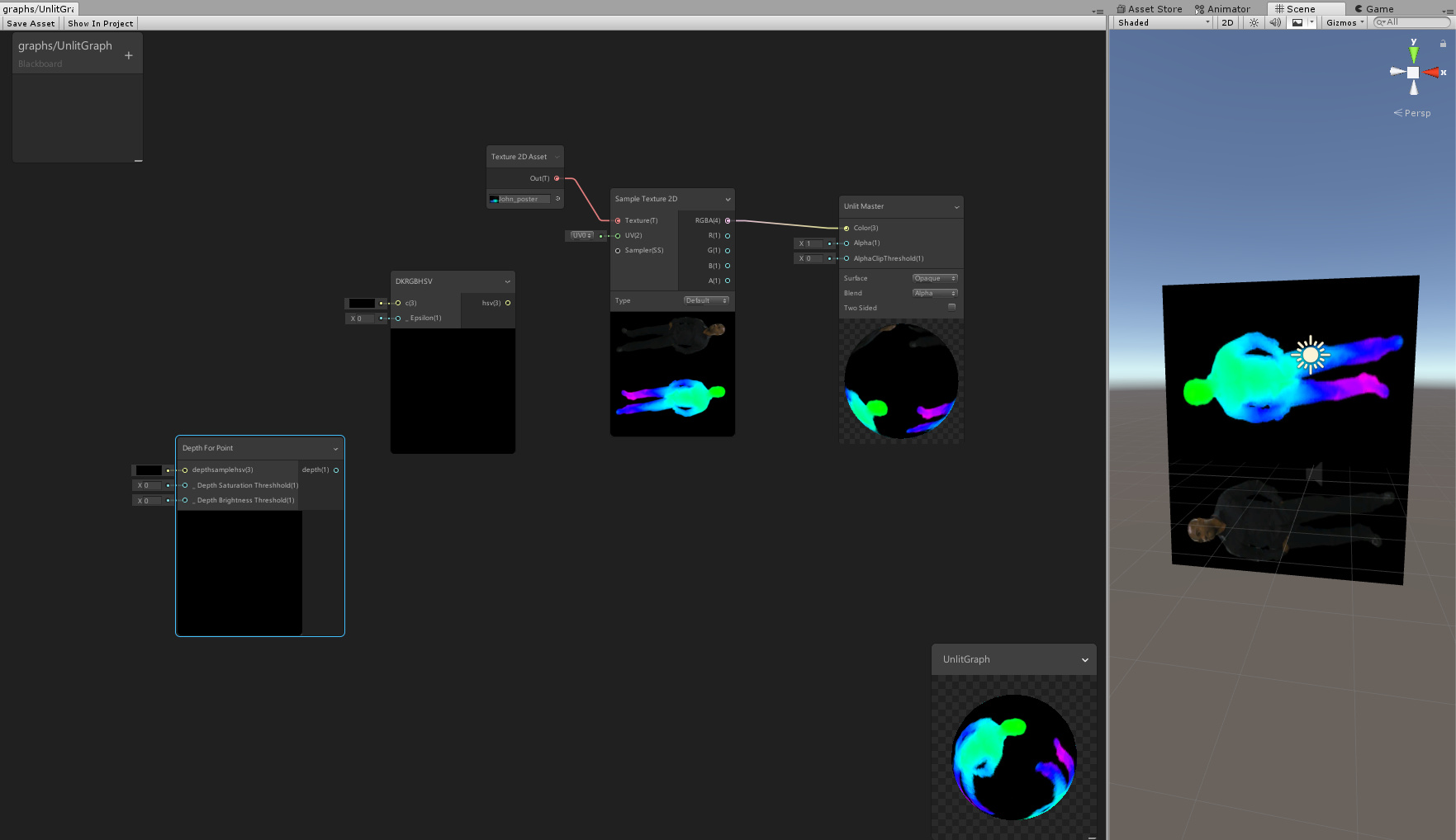

You can see that it isn’t the most “readable” code, but the key idea behind Unity’s custom shader nodes is that you essentially define some simple inputs and outputs, and then pass your shader code as a string.
So in the clampDepth() function you can see that I define depthsamplehsv, _DepthSaturationThreshhold, and _DepthBrightnessThreshold as inputs, and then define depth as my output. These variable names then directly map to the names used in the string function that is returned.
So currently I’m just converting .cginc functions! No fun visuals yet but slowly making my way through our code to get there!
