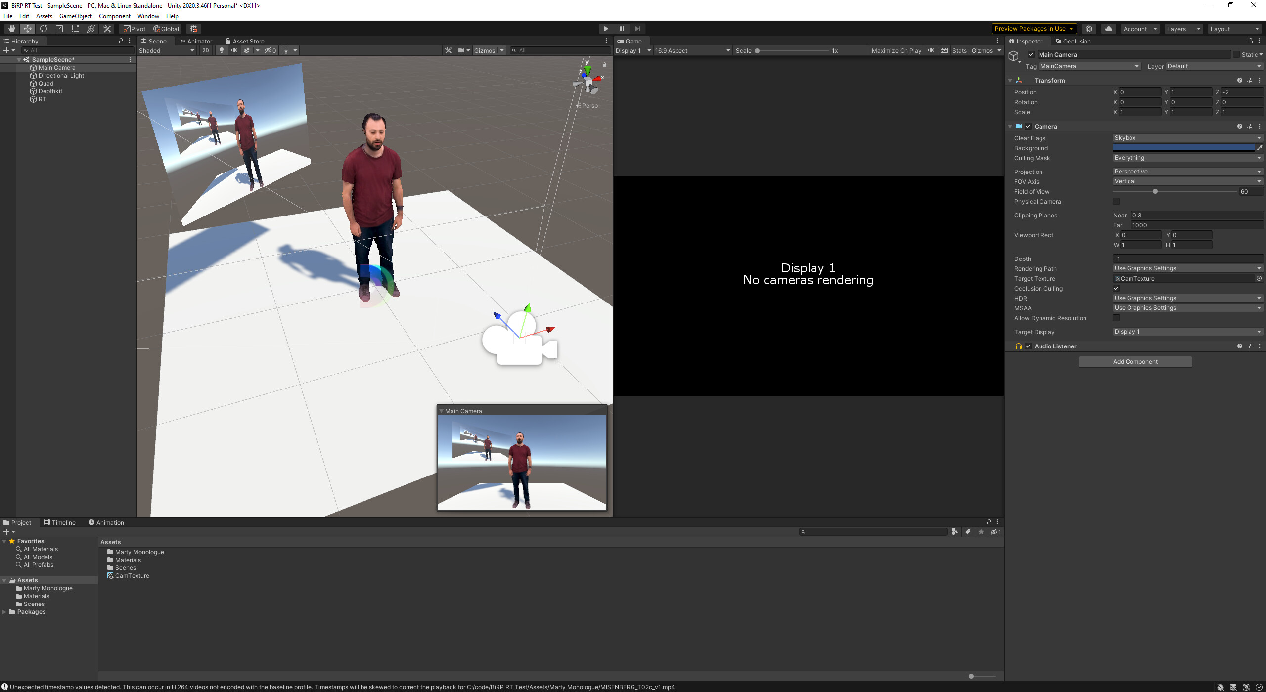

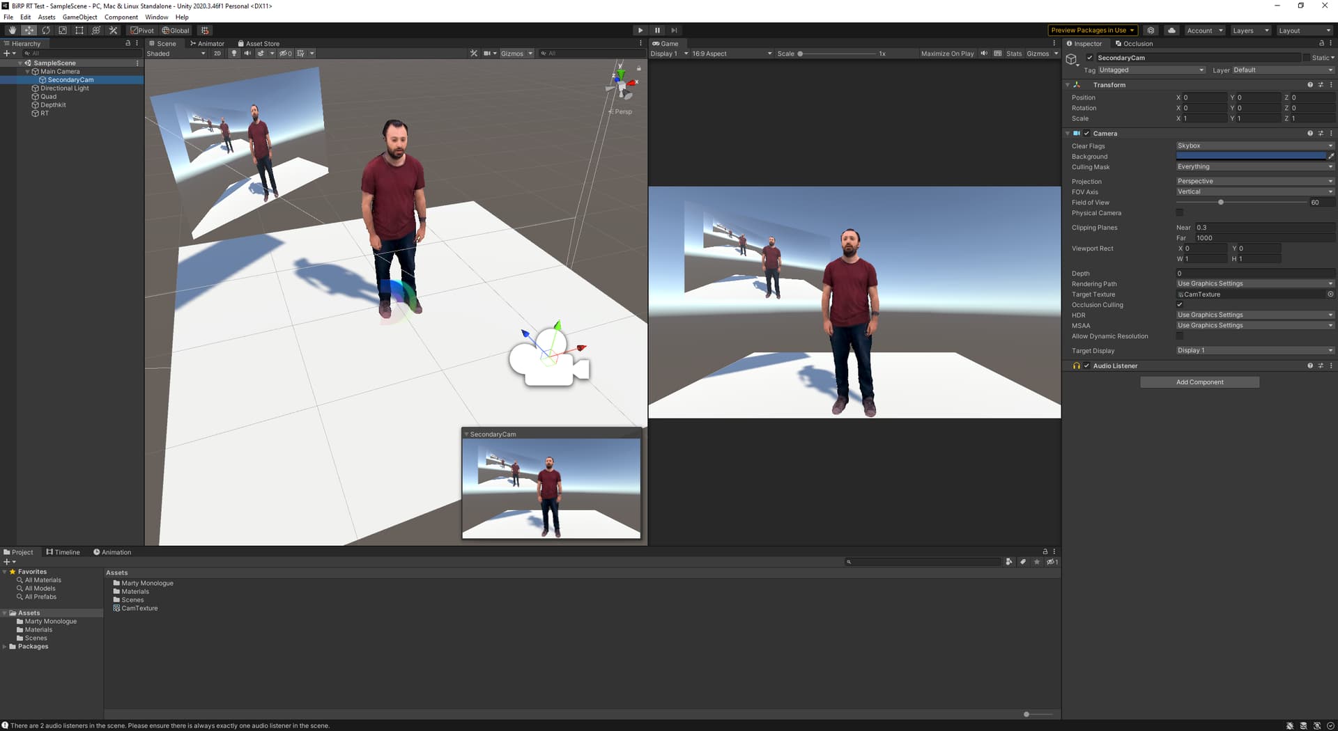

I threw together a quick scene in a Built-in RP 2020 project, and the Depthkit object is showing up in the Render Texture:
This is with a secondary camera rendering to the render texture.
This is with the Main Camera rendering to the render texture.
