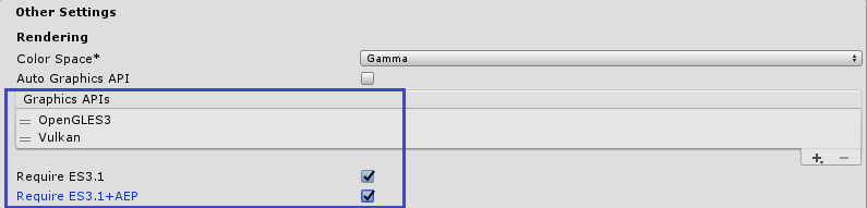

This is supported. However, the Depthkit Unity Plugin is incompatible with OpenGLES2. To publish to Android use the following settings under Player Settings -> Other Settings -> Rendering.
OpenGLES3 is supported by Android 4.3 (API level 18) and higher.

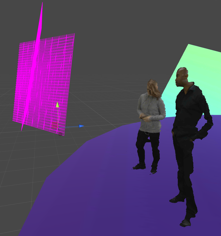

Once these settings have been adjusted, you may still see a pink material error in the editor as seen below.
To fix this, go to Edit -> Graphics Emulation -> No Emulation, to use the Hologram Look properly when creating for Android.
