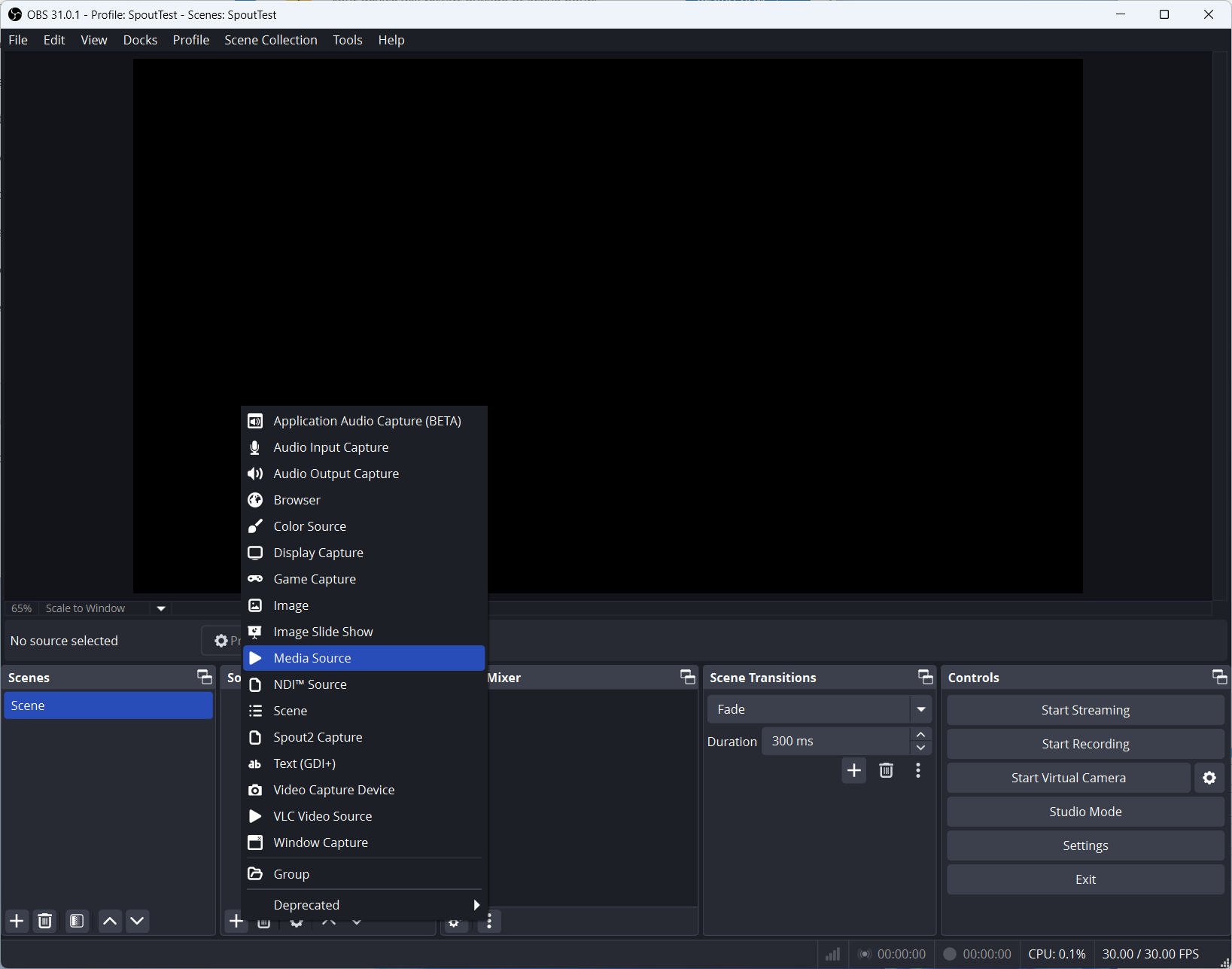

- In your OBS scene, create a new
Media Source. - Under local file, select the video of the Depthkit Combined Per Pixel you downloaded.

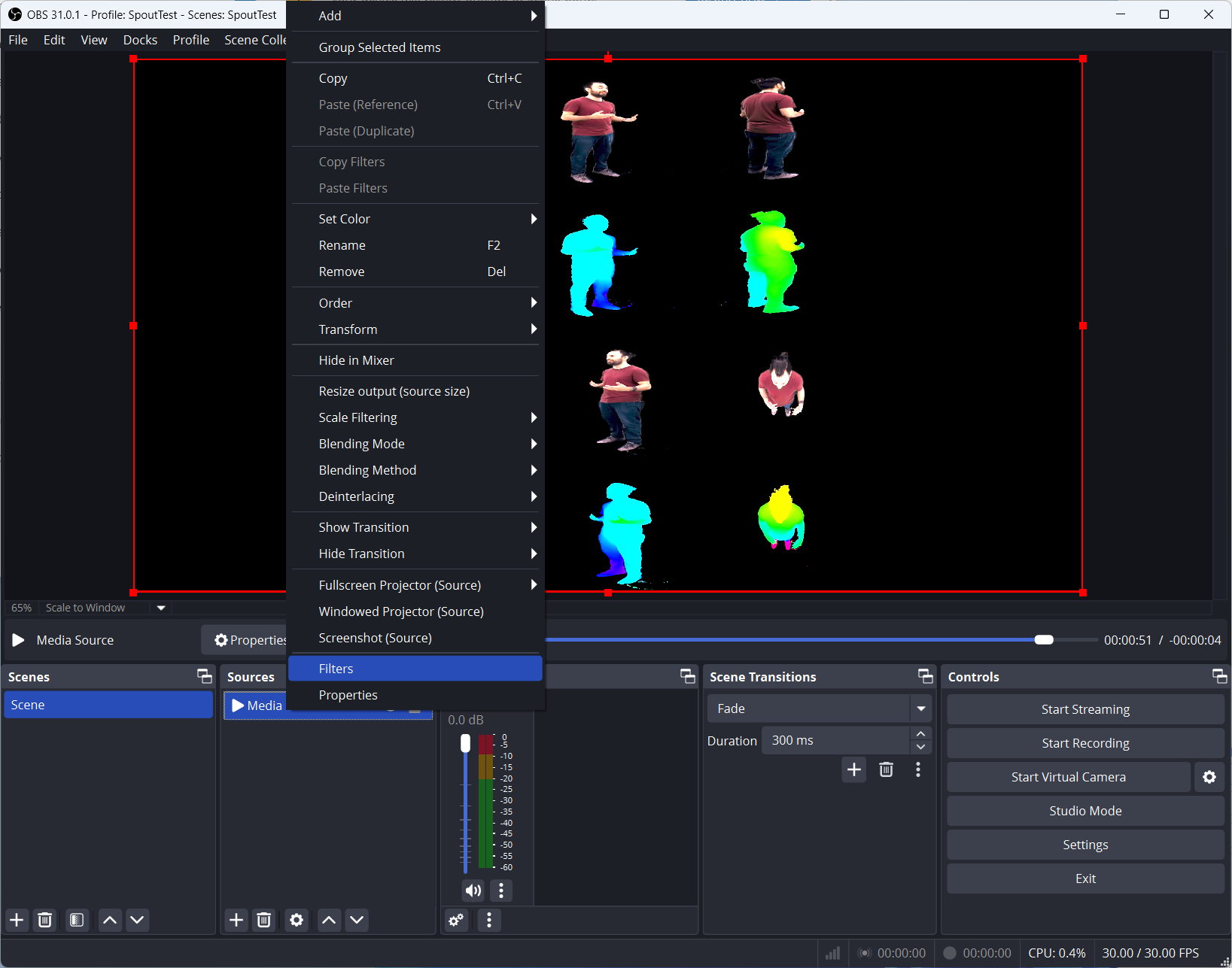

- Right click the
Media Sourceand selectFilters.

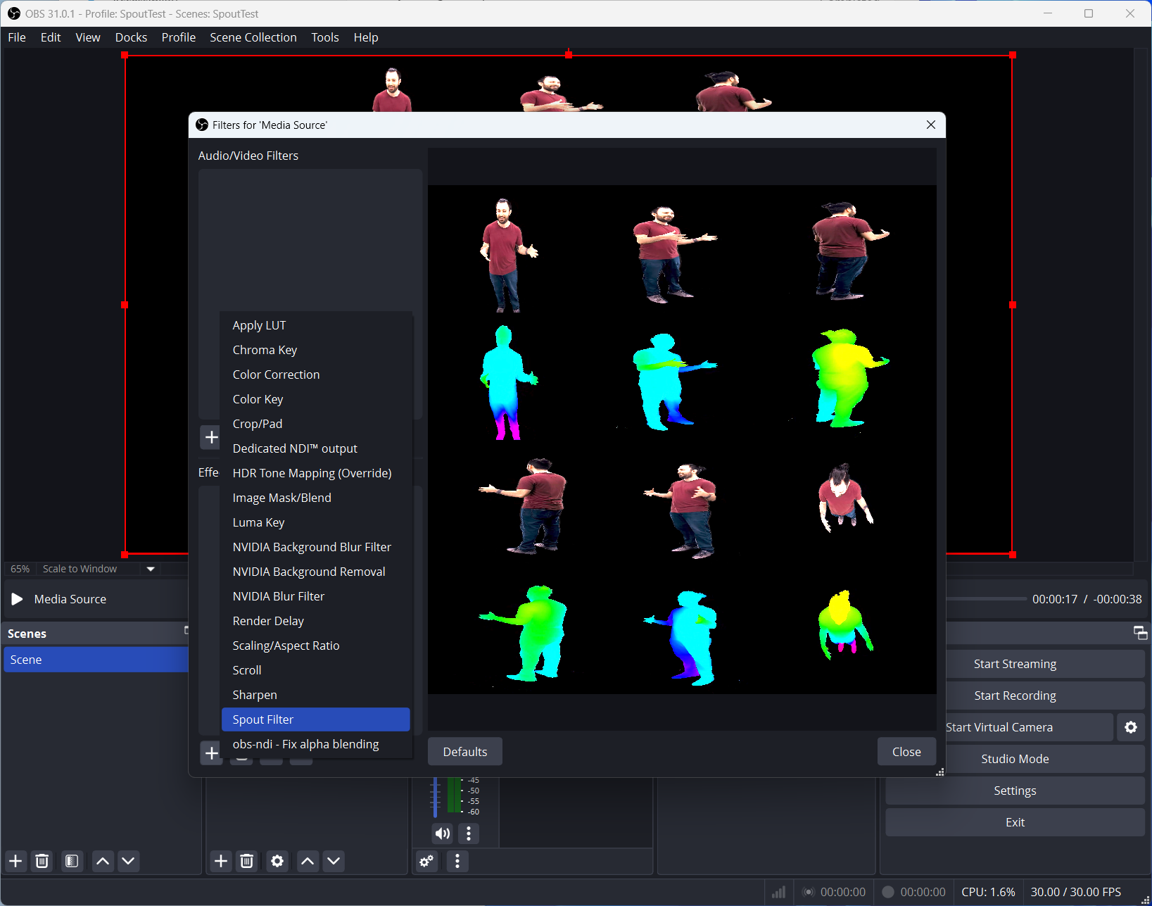

- Click the

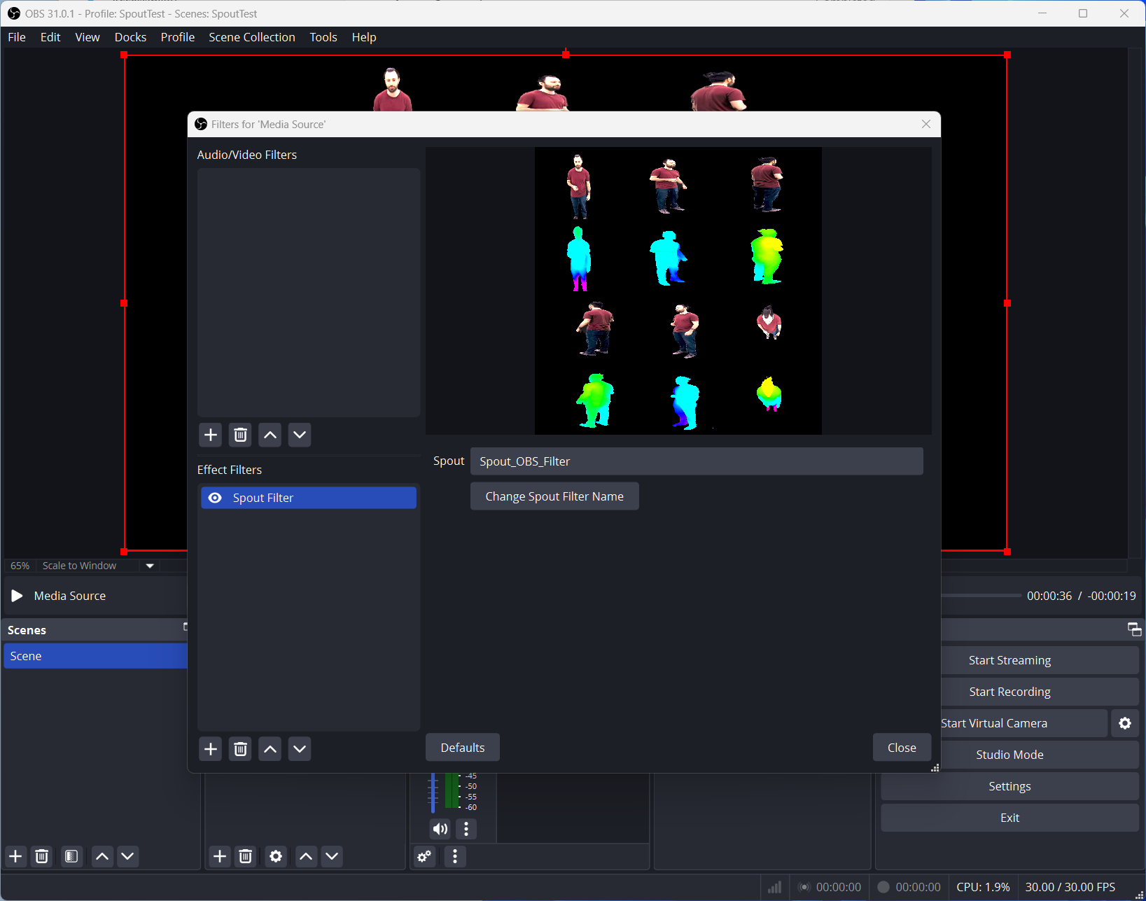

+underEffect Filtersand addSpout Filter.
- Optionally change the name of the Spout stream, and that’s all that’s needed to generate a Spout stream similar to that generated by the Depthkit application.

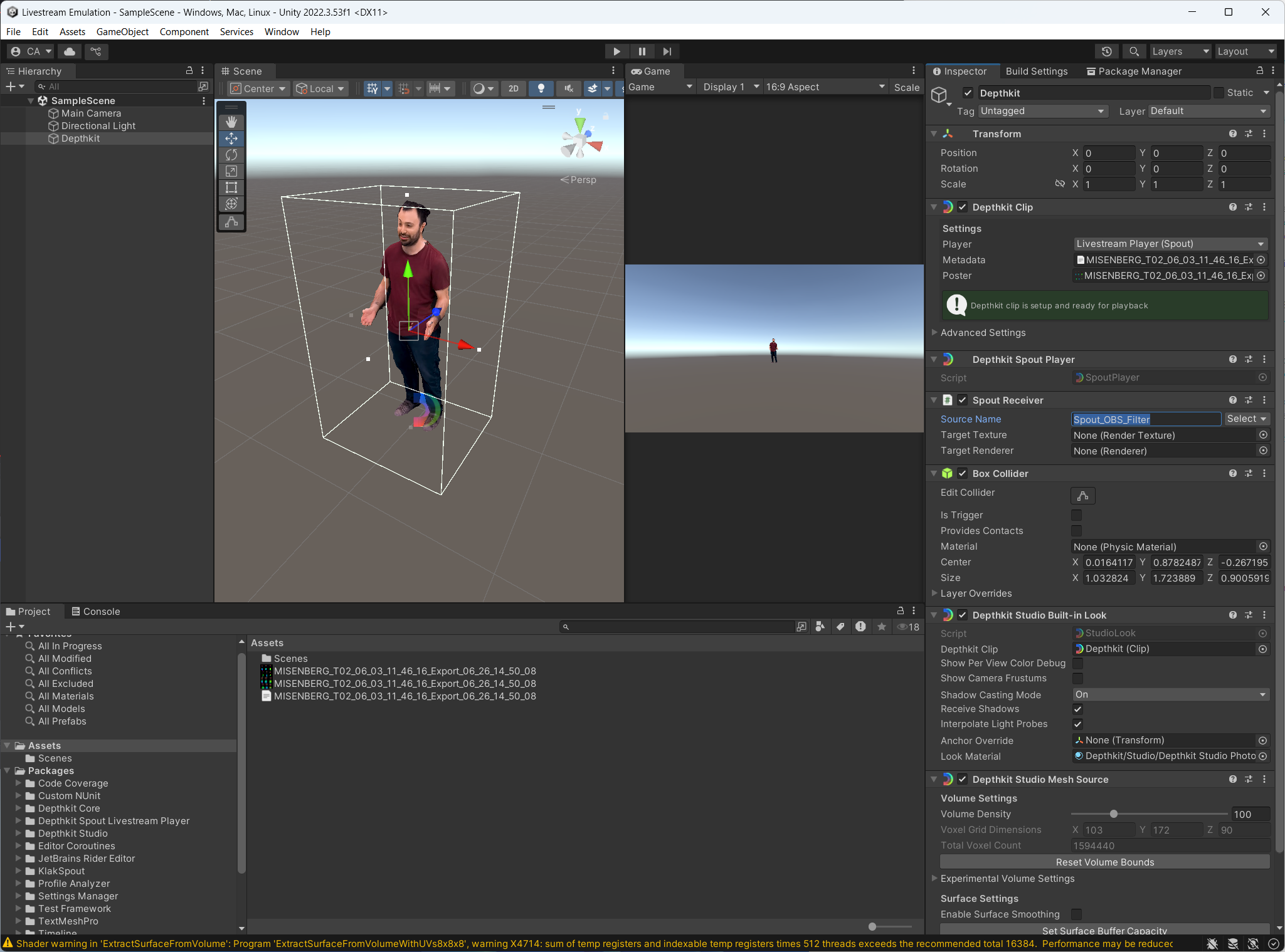

Follow the instructions for setting up Unity in the Depthkit Local Livestreaming documentation to receive and render the stream on the same computer, or the other livestreaming workflows to test the stream over LAN, WebRTC, or a CDN.
