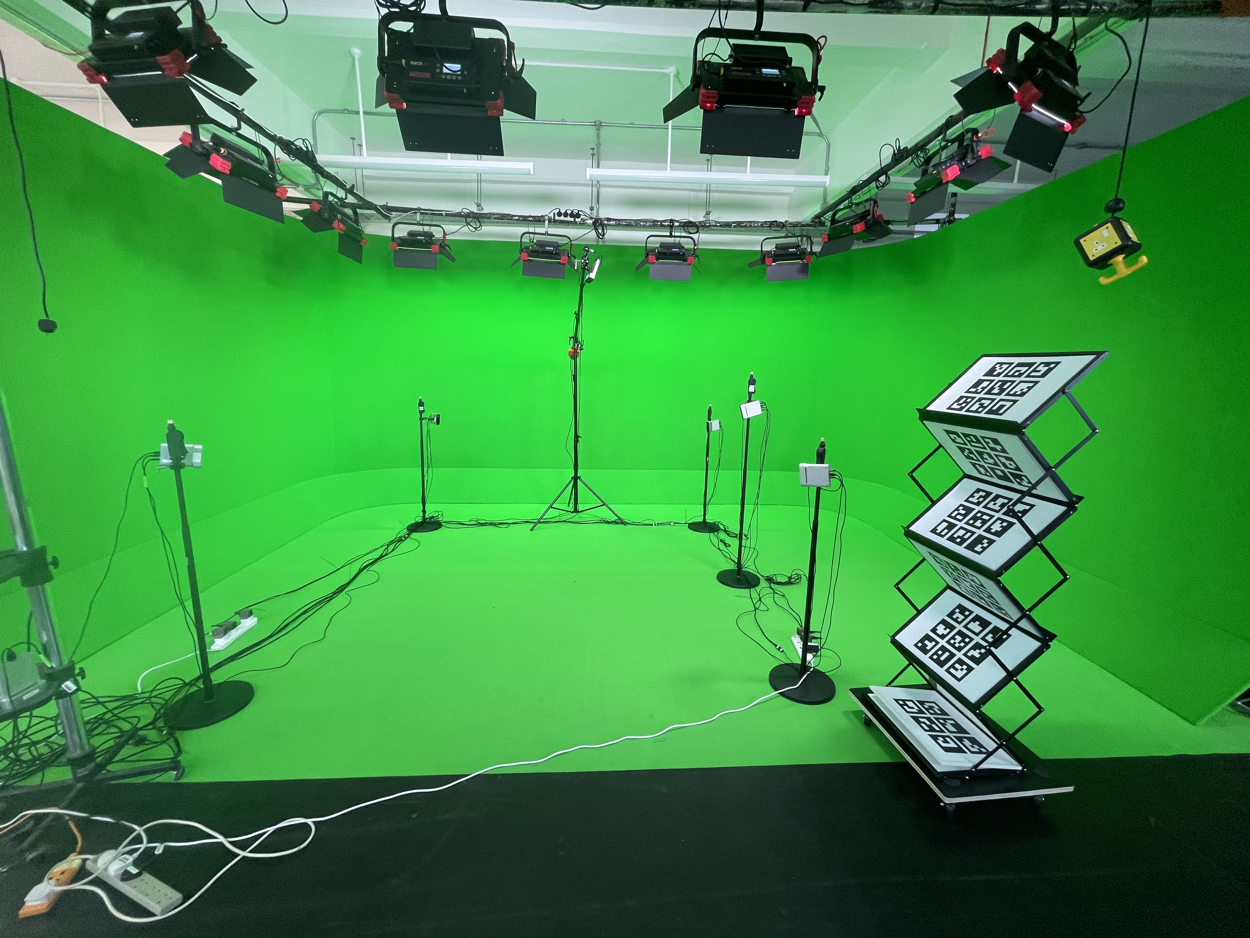

I set up a fixed 10 camera DepthKit Studio rig at University of the Arts London which works well with 1440p 30fps settings. I used this knowledge to configure a rig with 6 cameras now with 8 at the same settings.

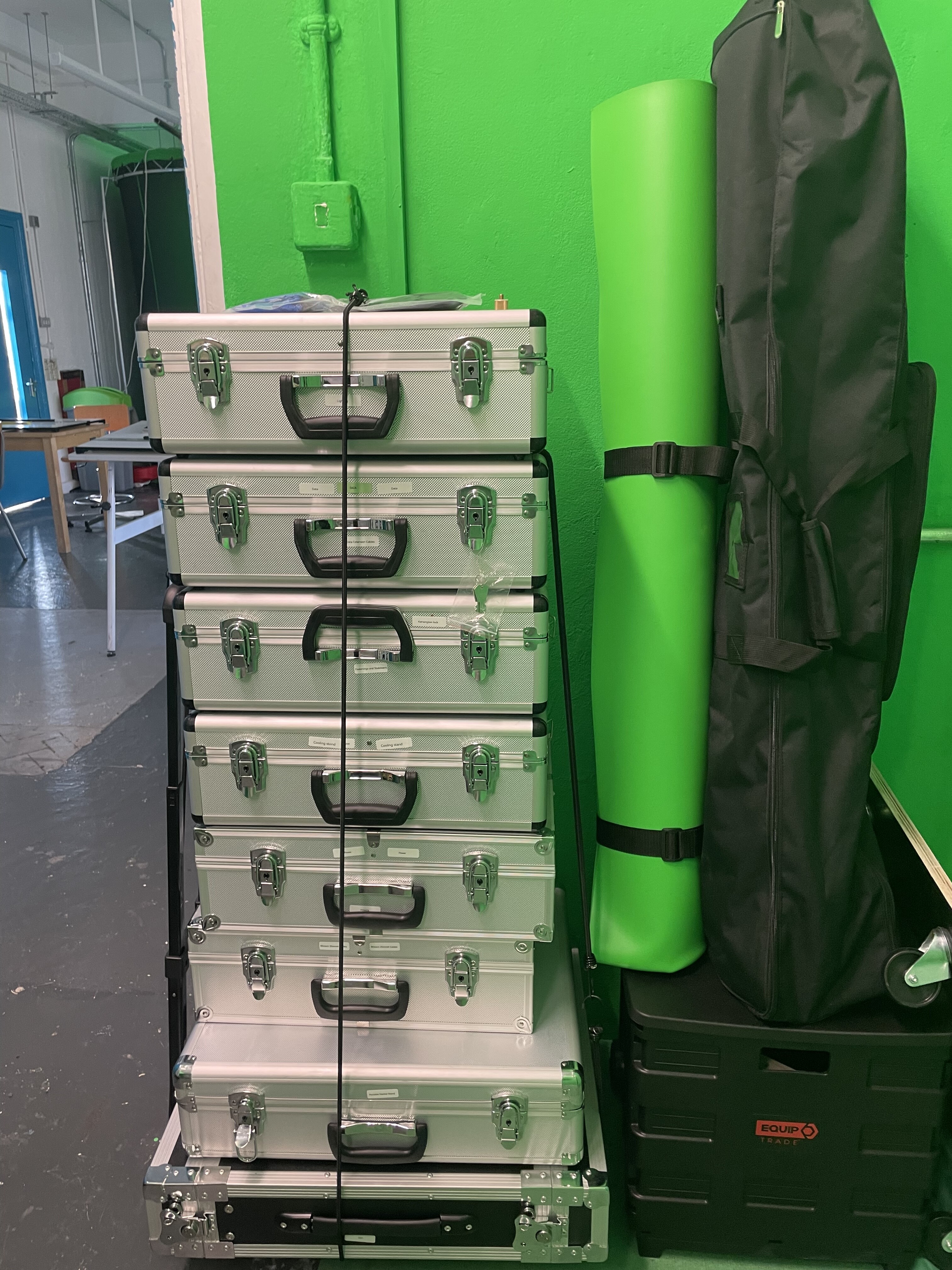

Pics are of 6 AK system, and packed 8 AK portable system running latest DepthKit beta without green screen and post capture real time view of stitched capture.
