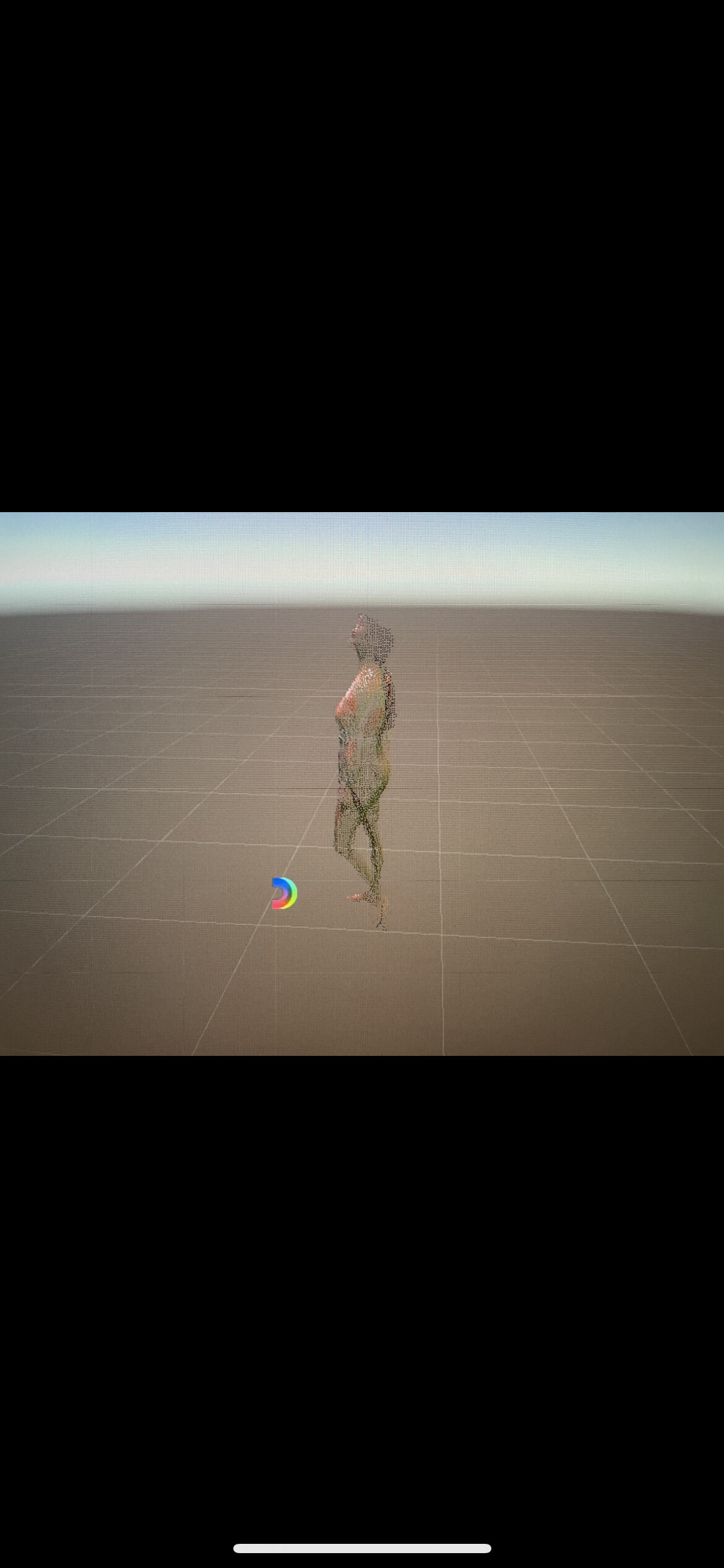

Never mind - it worked - and it is incredibly cool!!!

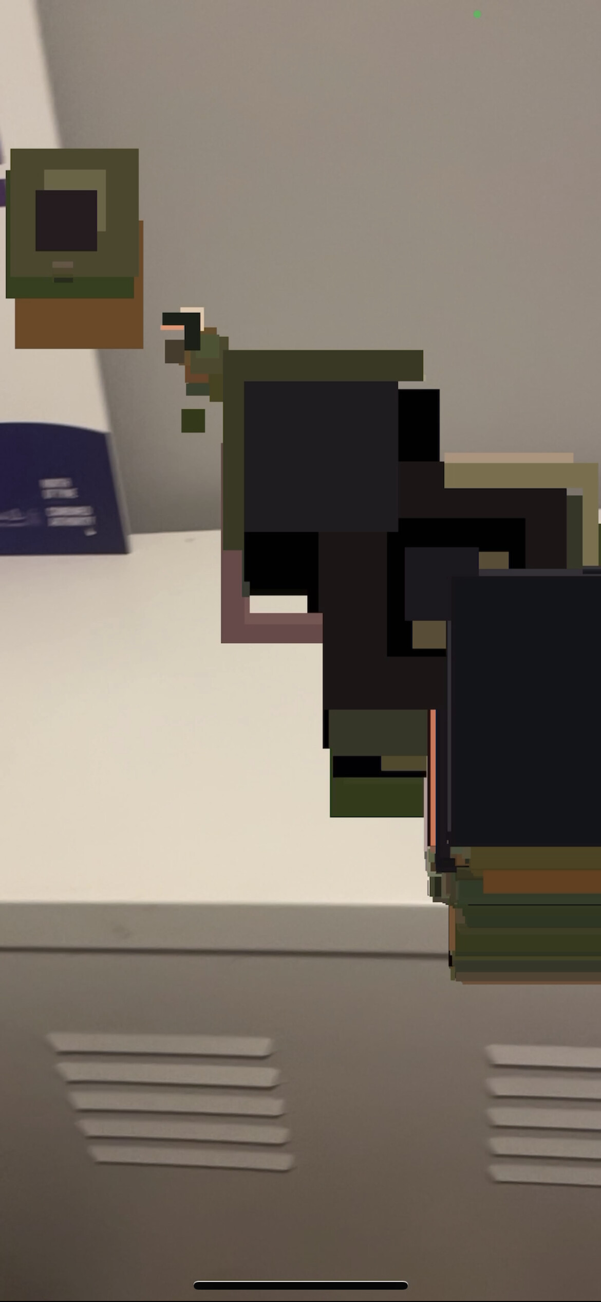

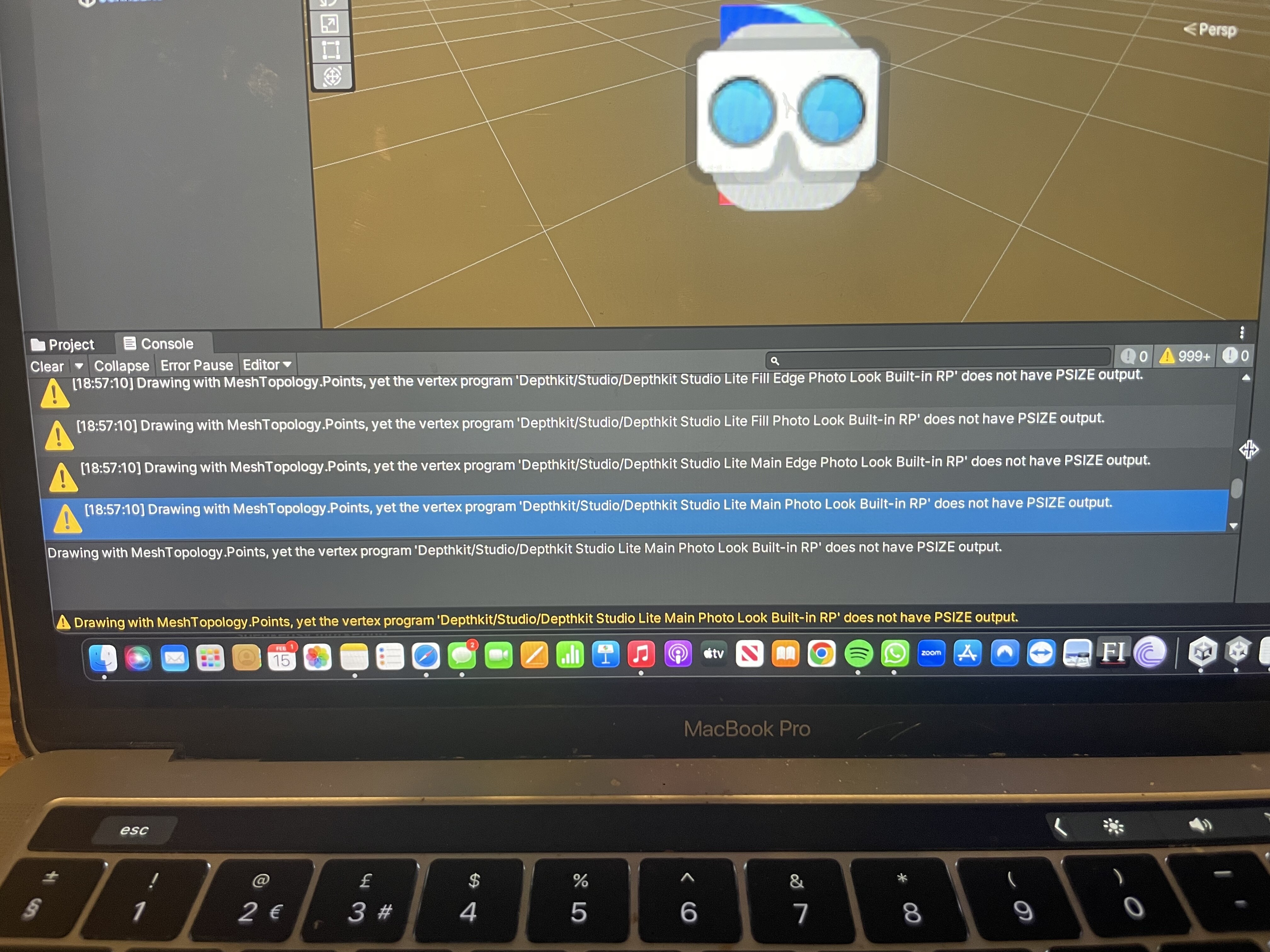

May have spoke too soon. Looks great in unity but when I built to mobile the points are huge - there was a warning that there was no specification of sizes of points in the project - any ideas?

Hi, @RobertGraham. Unfortunately, I am not familiar enough to help with workflow to generate particles in the Built-in Render Pipeline, and was hoping someone else could weigh in with an answer for you, but I’ll ask around and see if I can get more information.

Worth saying the point cloud view works perfectly in Unity, only on export it is going sideways!
