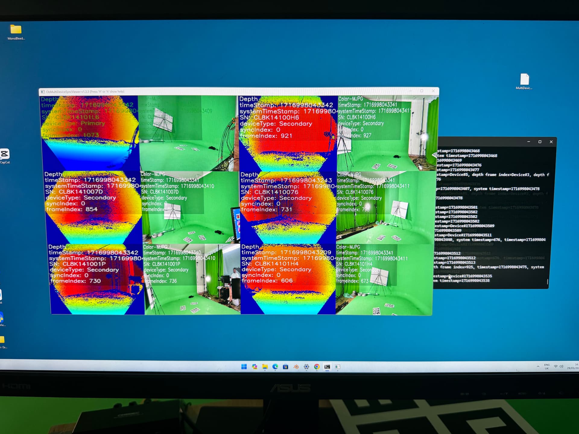

ObMultiDeviceSyncViewer setup.
When we open Depthkit, we can see 6 cameras live. When streaming starts, it runs about 5-10 seconds then frames start dropping and steam gets cut off. Similarly, the calibration automatically gets cut off.

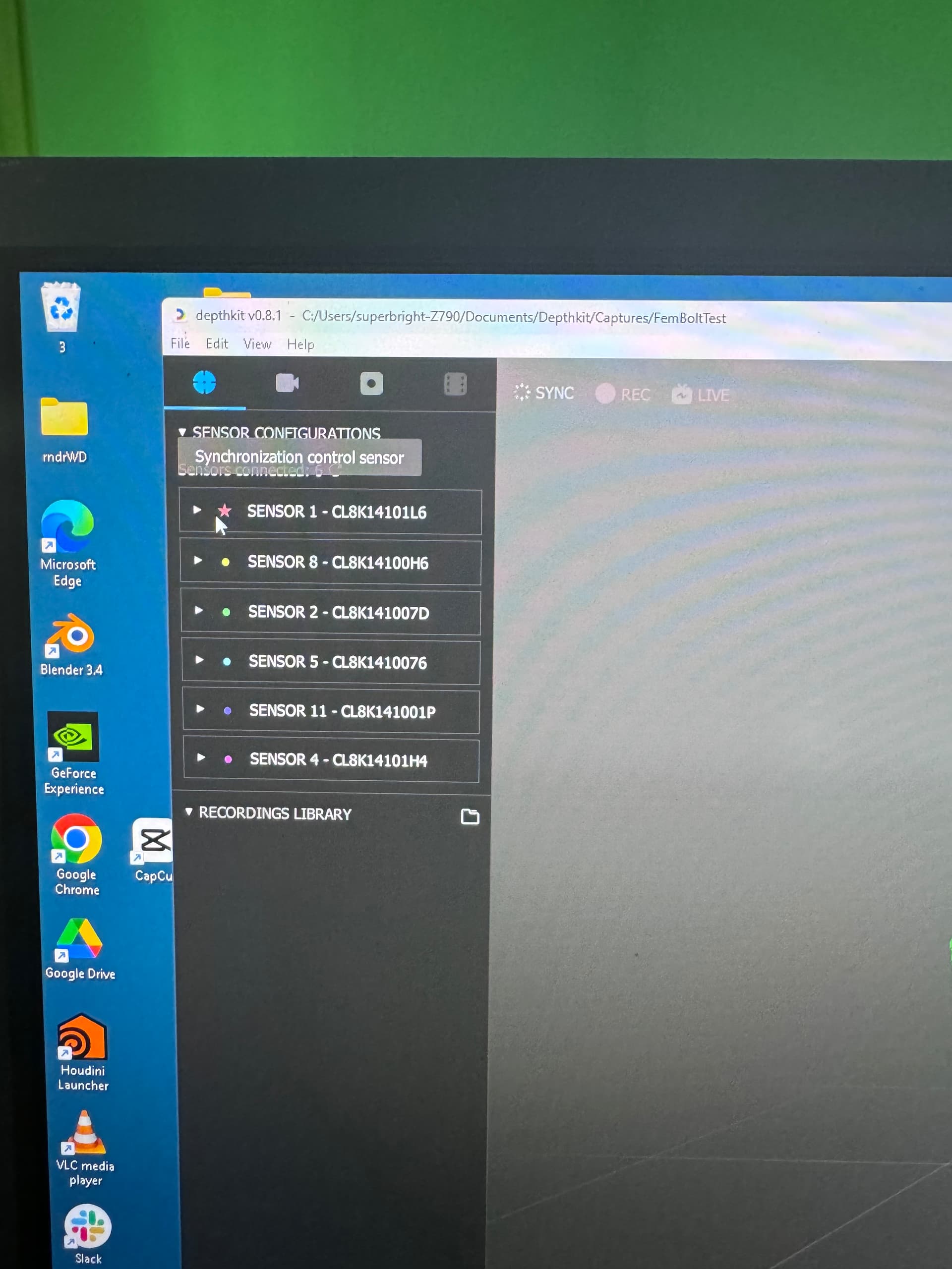

Igal Igal Nassima #2
Here is an additional image from Depthkit showing the sensor configuration:
