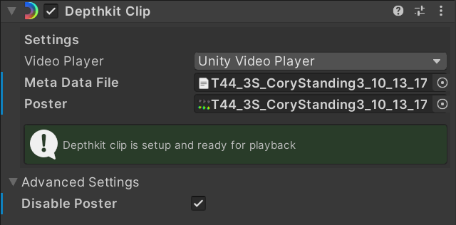

  1. Import the Depthkit Core Expansion Package into your project with your preferred Depthkit prefabs. Set up a Depthit clip by linking the metadata text file and Combined Per Pixel video. In the Depthkit Clip component under Advanced, select Disable Poster.

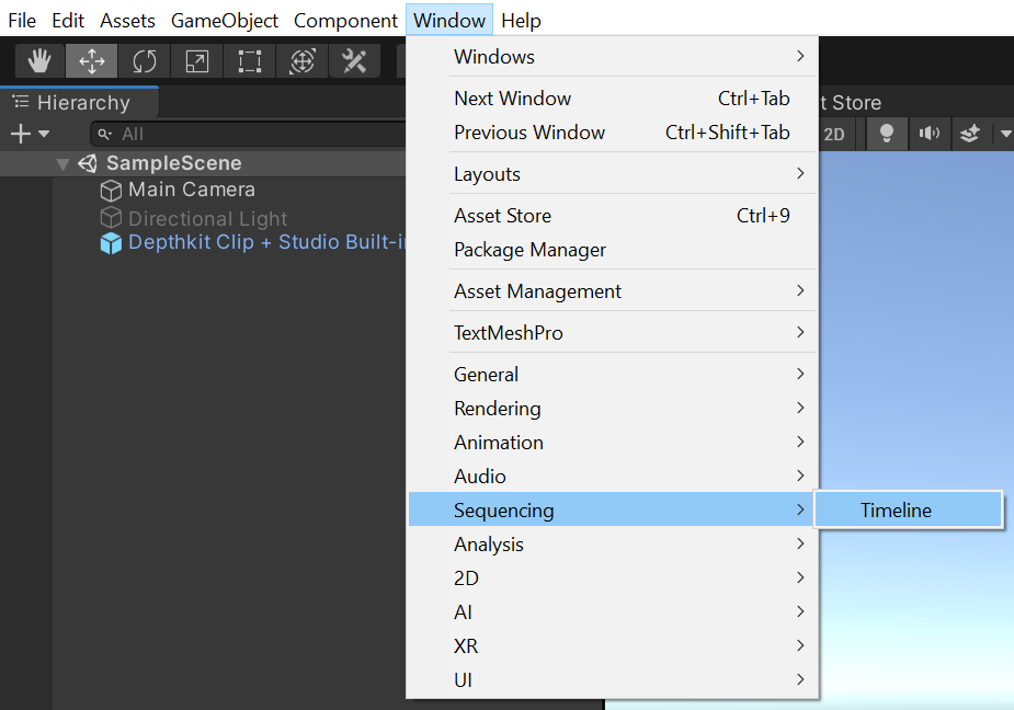

  2. Launch the Timeline by selecting Window → Sequencing → Timeline.

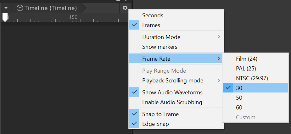

  4. Under the Timeline settings, set your frame rate to 30, to match your Depthkit asset framerate.

  • Ensure your Depthkit clip poster image is disabled under Advanced Settings.
