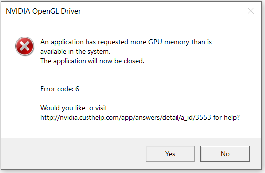

We’re having trouble opening up a Depthkit project the following steps cause a GPU Error.
  • Open DepthKit Appliction
  • Launch Project
  • GPU error happens
GPU error
I’ve made a quick fix by creating a new project and bringing over the calibration meta over but we need to get access to the original project to export all the clips we recorded.

Hi, @JonathanForder2 . We have seen this happen in Depthkit projects containing many recordings, and documented a workaround here. Let us know if this enables you to work on and export your clips.
