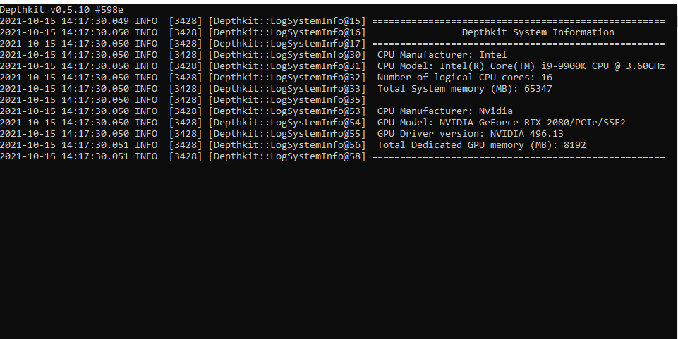

Do you know if Depthkit can use two graphics cards ? If not, can it cause an issue to have two cards installed and would you recommend to take one off ? We have two (the same one) but only one is detected by the software.
cf. picture attached, including all our system hardware specifications :

With regards to 2x graphics cards, we have not tested Depthkit is not designed to take advantage of dual graphics cards, and we haven’t tested ourselves on dual graphics cards systems. It’s very likely that the two graphics cards may cause issues. I recommend taking one card out if you are experiencing instability
