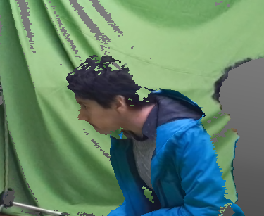

Hair trouble2
Hello, I have a problem when recording, the person’s hair disappears, even when he bends down, it’s just the hair and if the person wears a hat it fixes itself, what could be the cause of this?
@claudioInostroza - From your screenshot, it looks like the sensor is having trouble detecting parts of the hair due to how the depth sensor in the Azure Kinect works. You can learn more about this in our documentation about material constraints.
For hair specifically, we been able to successfully capture reflective hair textures by spraying dry shampoo in the subject’s hair before being captured. This makes the hair less reflective, and easier for the sensors to capture.
A word of caution: Aerosols sprayed in the same room as the sensors will leave particles in the air which can interfere with the depth capture, so be sure to use the spray in a different room than your sensors.

Also frequently had this issue. Tried the shampoo idea which worked a bit but not completely for us. Always meant to spend a full day trying out other ideas but haven’t got around to it yet.
