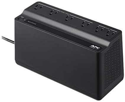

Hi Cory, I found this technique online and I’d love your thoughts on it:
I’m looking for a solution that is small enough to fit in a standard backpack along with a gaming laptop and the Kinect itself. I know it’s an odd ask, but i’m exploring DK use cases for journalists in the field.
  • Henry
Cory Cory Allen Alpha User #5
The APC is going to be far less portable than adapting a 90AH NiMH/Lithium-Ion battery, and also might beep if you aren’t plugged into a wall, but it will work with the Kinect AC power supply out of the box with no modification.
The battery solution described in the paper requires more work to assemble up front, but will easily fit in a back pack, and be relatively lightweight, and can accommodate batteries that are readily available all over the world. (You could even hook a car battery up to it and it will work.)
