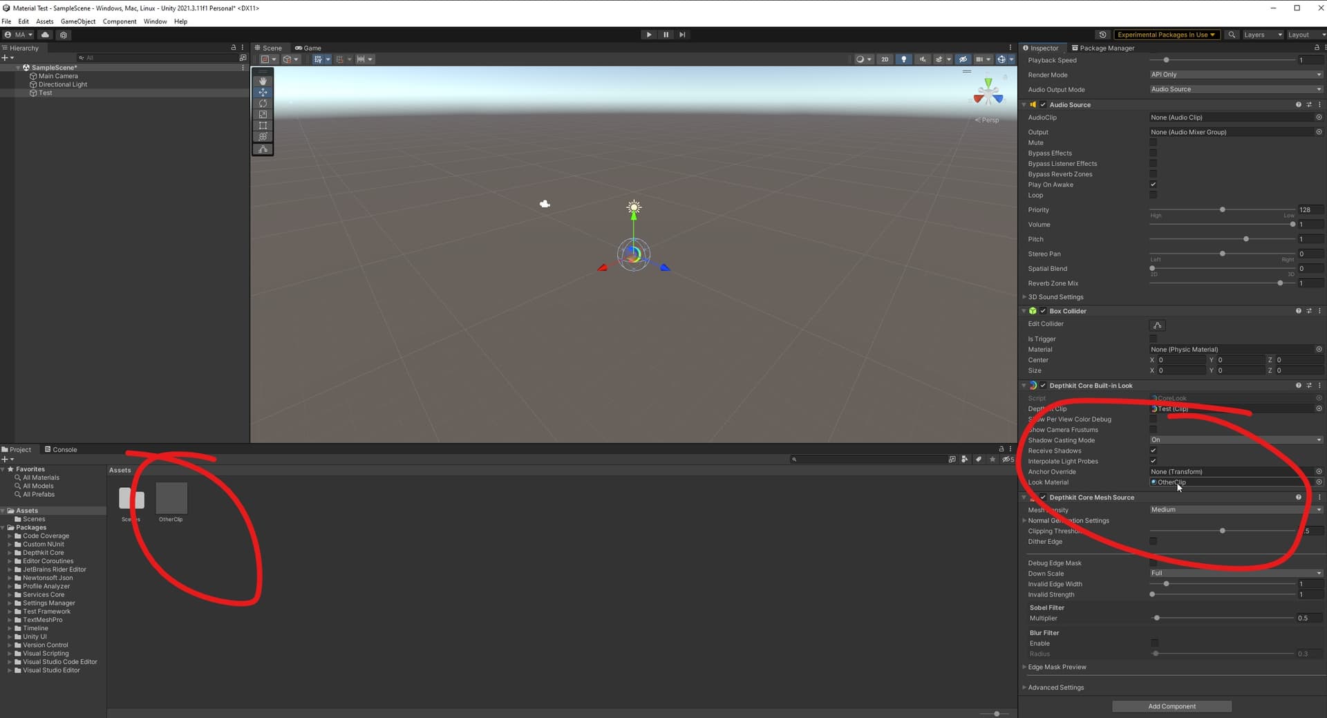

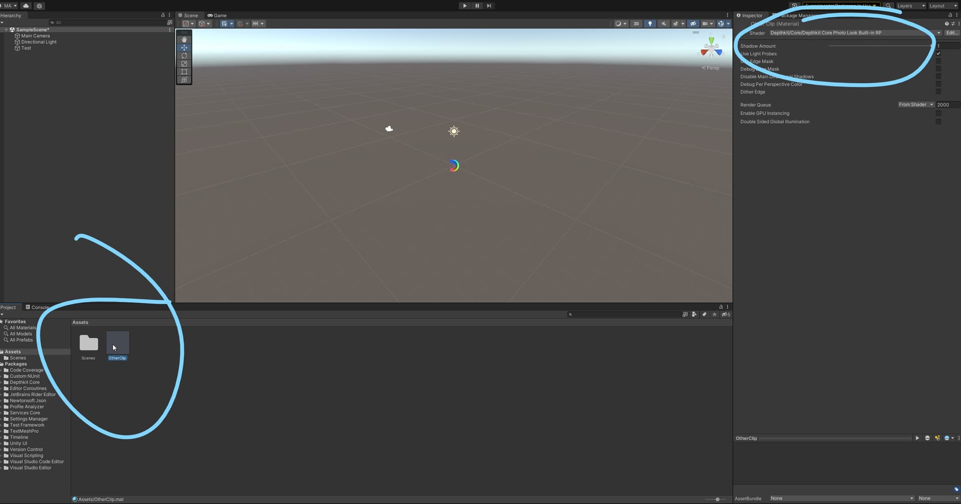

To configure clips with separate materials:
  • Create a new Material
  • Set the shader to on the new Material Depthkit/Core/Depthkit Core Photo Look Built-in RP
  • Swap the default Material on your Clips’ Depthkit Core built-in Look ‘Look Material’ to the custom materials
See screenshot below for hints on setting this up
