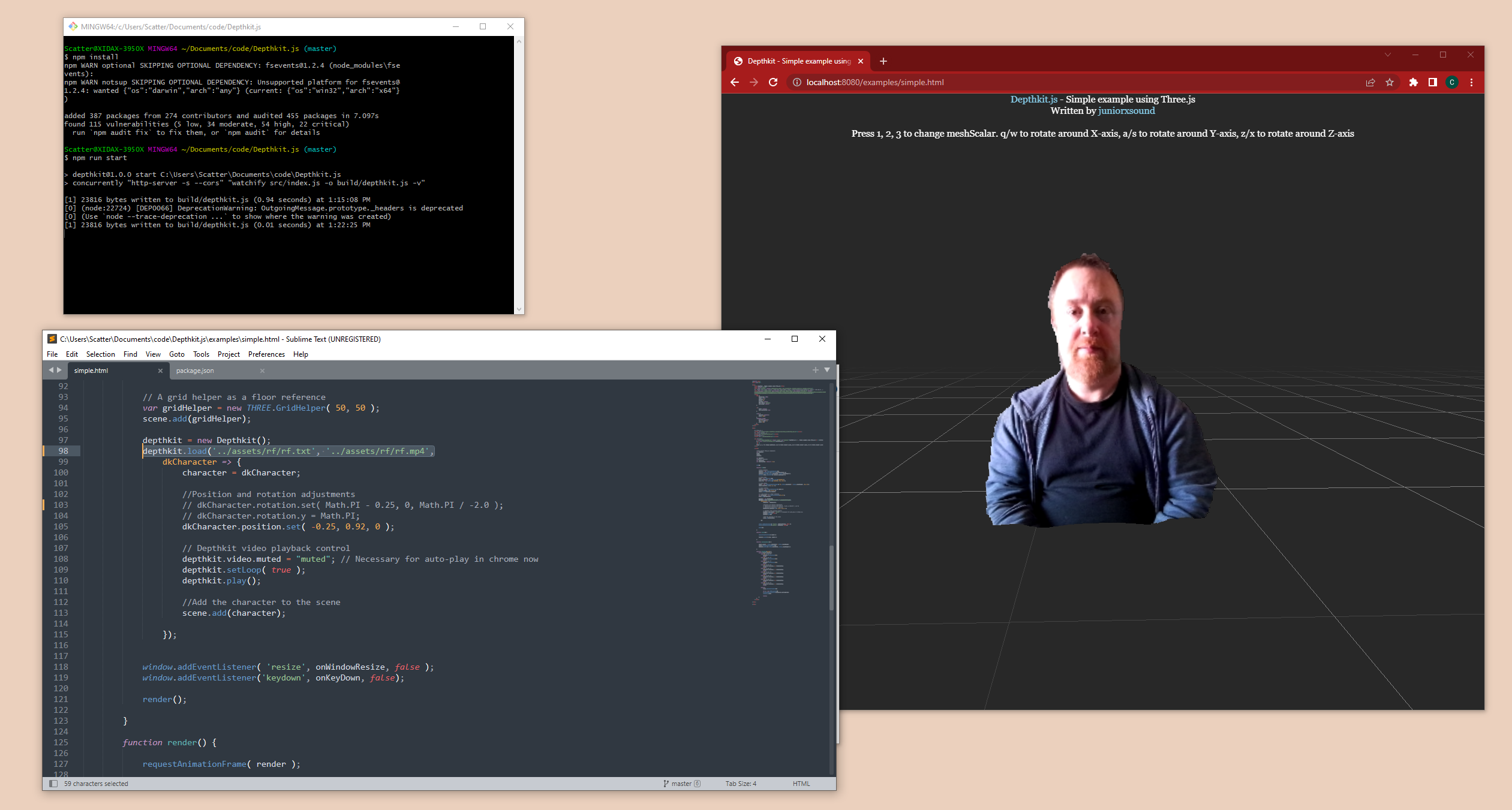

@RobertFarthing1 - I worked on this a bit with my team, and was able to get your asset to load as you sent it without any modifications:
A couple of things worth mentioning:
  • The readme on our repo currently offers Node.js as an alternative way to install Depthkit.js, but this is not maintained, and likely points to an old version. Instead, use the version included with the example or build directly from our repo. I am updating the readme to reflect this.
  • I am also updating the readme with a getting started section to clarify what each command is doing, and how to get feedback as you set up.
EDIT - The Readme is updated.
