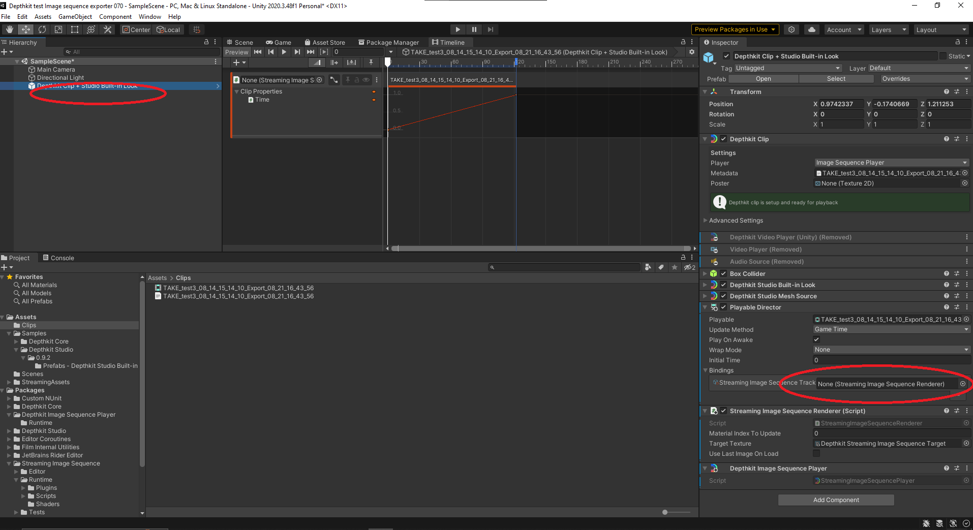

MartnD Martn D #3
With the old exporter I have no issues at all.
It worked very easy .
The new from 070 to s not working!
This pictures are done with the new 070 exporter and in the new the binding and image target doesn’t pop up for me ?
i followed all the rulles form here
Non-realtime playback (depthkit.tv)
for 2019.4.3f1 and 2020.3.48f1 ???
and with the unity image sequence streamer for unity and github and so on …
all like it is discriped
but the one thing what I circled doesnt happen for me → so I cant start the tests with the new Transformer / Exporter … ☹️
Greetings Martn
