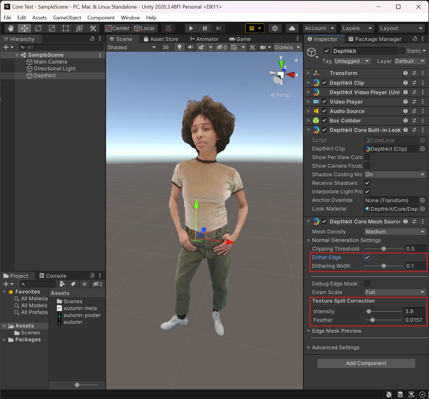

@AnuragPaliwal - Thanks for sharing the video. There are two areas of the workflow which can reduce/eliminate these “webby” artifacts you are seeing:
  • If you have Refinement enabled in the Depthkit Editor, try applying higher Sharpness and Color Contribution values, and lower Filter Size and Fill Amount values, and re-export.
  • In Unity, raise the Dithering Width and Texture Spill Correction values (see highlighted area in the below screenshot) until the lines disappear.
Let us know if the issue still persists.
