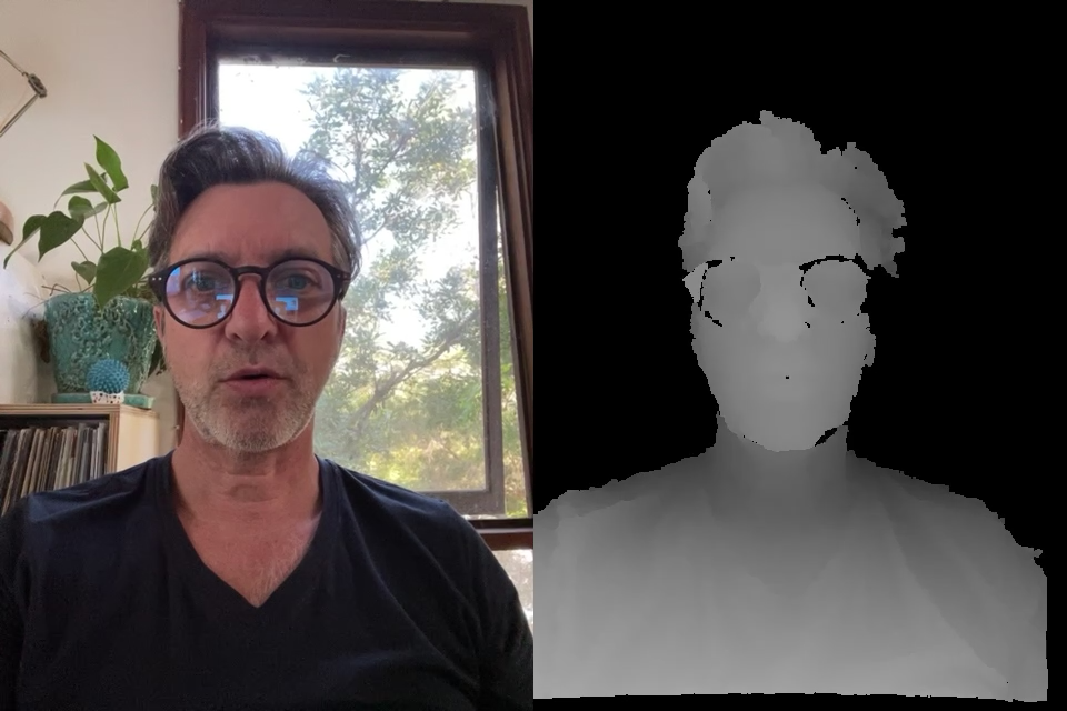

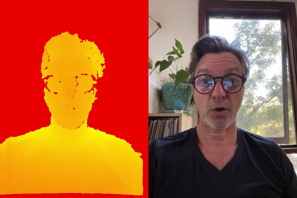

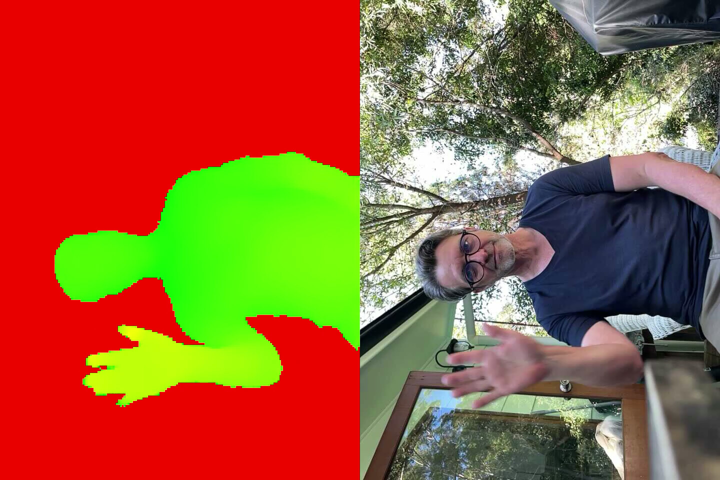

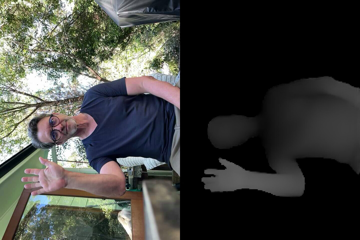

Anyone tried to use the depth sensing cameras (front facing and rear facing LIDAR) for Depthkit?
With the record 3D app, it is possible to export an RGBD MP4, but I think the depth encoding is different to what you get from a Kinect.It is a also possible to export with a grayscale depth map. See pics below.
But this would be a great and portable RGBD video capture option for DK.

VolkerKuchelmeister Volker Kuchelmeister #4
Did you change the layout only, not color of depthmqp?
I t appears to me the depth color coding of the iPhone is different to Kinect.
