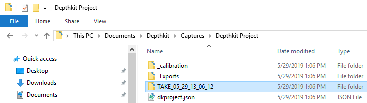

Yes you can @JordanShaw! You just need to make sure you are transferring the entire project, which includes:
  • The _calibration folder
  • Takes
  • The _export (if you have them)
  • The dkproject.json
These are all within the Depthkit project.
Important note to keep in mind, Depthkit does not like to read footage from an exFat drive. If opening the project from an external drive, make sure you use NTFS as your hard drive format.
