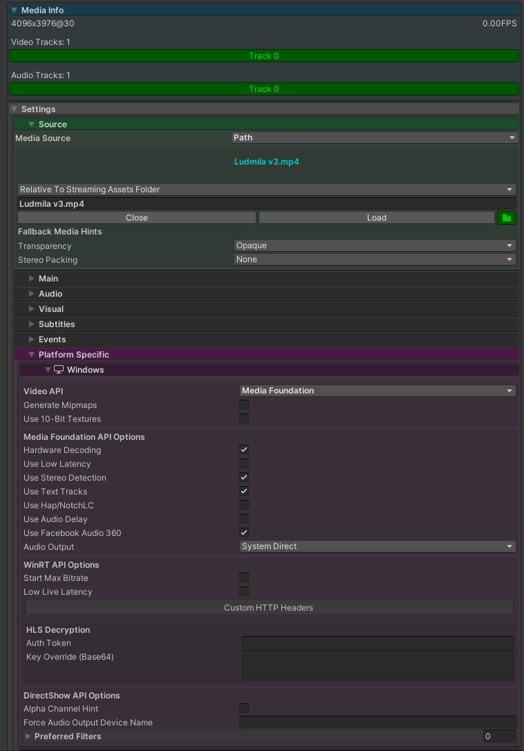

We’ve done a capture sessie in Depthkit Studio last week, captured four singers, and we’re now implementing this in a Unity project. We’re trying to play back our four DepthKit videos using AVPro.
We see a large drop in frame rate between the playback of 3 clips and 4 clips. Playback of 3 clips the frame-rate is 240 fps and if we add the fourth clip the frame-rate drops sharply to 6-7 fps. Do you know what is happening? Is there any way we can play 4 simultaneous clips at a frame-rate > 30-75 fps ?

  • Unity version: 2021.3.11f1
  • Resolution of clips: 4096 x 4096, mp4 codec

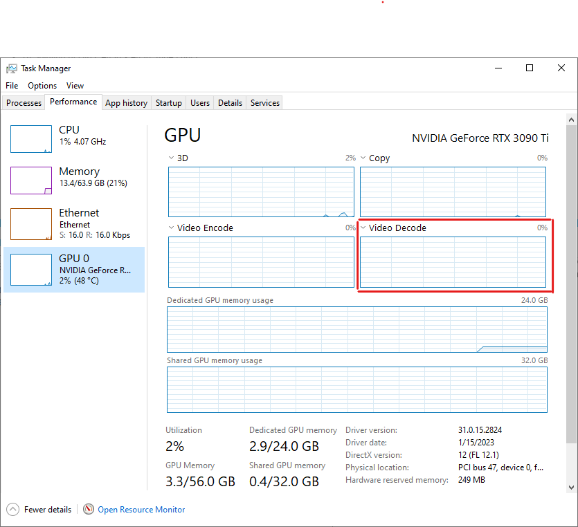

@doubleA Based on what you shared, it’s tough to know for sure, but I suspect that the GPU’s decode capability is saturated when trying to decode 4x 4096x4096 videos simultaneously. You can monitor this in Task Manager’s Performance tab by selecting the GPU:
If Video Decode utilization hit’s 100% during playback, that’s likely what’s causing the low framerate. To address it:
  • Scale some or all of your videos down to a lower resolution (e.g. 2048x2048) until simultaneous playback comes in below 100% Video Decode utilization.

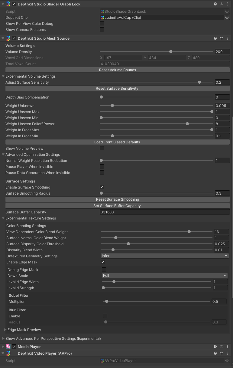

  • Your volume density is set to 200 - This provides the high quality for non-realtime workflows, but can lead to low performance for realtime ones. We recommend bringing that down to a value of 150 or lower for all of your clips.
