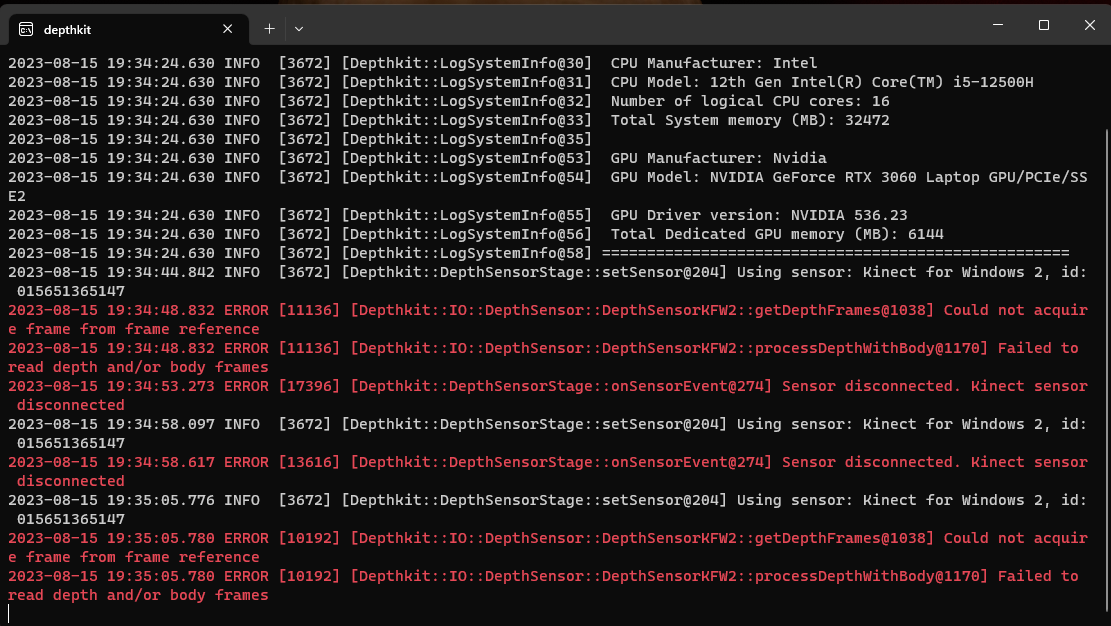

Hi there
I am a complete noob with VolCap. I have a licence for Depthkit Core and am trying to set up my Kinect for Windows 2 sensor. The sensor keeps disconnecting. It works for a few seconds and then disconnects. I have tried using different ports on my laptop, but that is about it. Please see the image below:
Thank you for your help!

@MarindaBotha Welcome! Sorry to hear you’re experiencing this issue. I’ll share this with our technical team, but in my experience, an unstable connection is usually either due to:
  • insufficient power
  • or an incompatible data connection via the USB port.
Have you followed the Kinect v2 compatibility and intermittent connection (1)(2) sections of our documentation?
Does the Kinect Configuration Verifier tool reveal anything? Let us know, and we’ll do our best to help you narrow down the cause of the issue. Thanks!

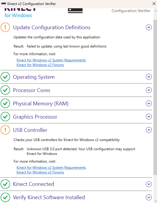

Thanks very much for the quick response and information. I have worked through the documentation you suggested but the issue still persists. I use USB 3 ports, the newest driver is installed, sensor is plugged in straight to my house’s main power supply, I checked the performance of my system, nothing is draining power.
The Kinect Configuration Verifier tool does reveal that there is still a USB port issue, but it also states “Update configuration Definitions … using last known good definitions”. I’m not the most tech-savvy person, so perhaps the solution is quite simple. Please see the screenshot attached. Thank you for your help.
@MarindaBotha Thanks for sharing the screenshot. It looks like the Kinect may be plugged into an incompatible USB port. Have you tried any other USB ports on the computer? Do they all produce the same message in the Kv2 Configuration Verifier?
Have you also tried uninstalling and reinstalling the Kinect for Windows SDK?

@MarindaBotha Can you confirm the name of the USB Host Controllers behind the ports on your computer? You can find the name of your USB Host Controller in Windows Device Manager by following this section of our Sensor Connection troubleshooting documentation. These should either be Intel or Renesas controllers (per Microsoft’s documentation). If the chipsets of all of the USB ports are incompatible with the Kinect v2, you’ll need to use a different computer.
