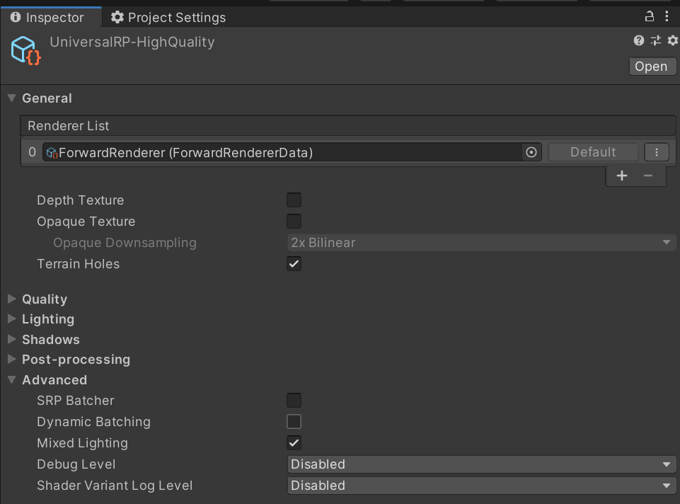

Playback Issue with Multiple clips in URP or HDRP
When working in a project using URP or HDRP, you will find that multiple Depthkit clips can default to sharing the same texture. To work around this, disable SRP batcher in your project. You can find this by locating your render pipeline asset in your project (usually under Assets / Settings), selecting the asset and going to the Inspector. SRP Batcher is located here under the Advanced section.
If you are unable to disable SRP Batcher, you can create a new Core Look Shader Graph and material for each additional Depthkit clip.

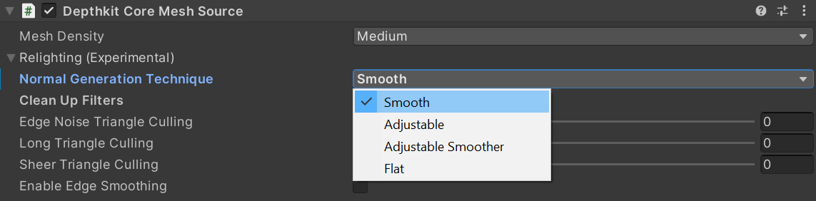

Errors in Self-Shadowing in Built-in RP
When setting up your Depthkit clip, you may find that its shadow is speckled or full of holes. Don’t worry, there is a quick workaround. Select your Depthkit clip and head over to the Inspector. In the Depthkit Core Mesh Source component, under Relighting, change the Normal Generation Technique to smooth, adjustable, or adjustable smoother.
