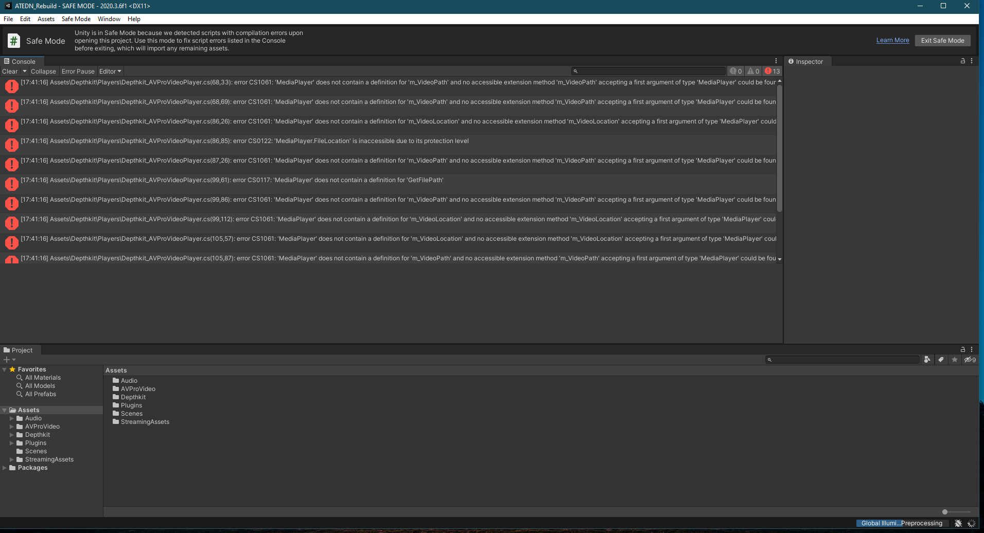

Just upgraded my AVPro, and it kicks up 13 critical errors in the Depthkit_AVProVideoPlayer.cs script, all media player related. Before I try to resolve them all – is there an updated version of that script?

Hi @gameplaylab! Any chance you can share a screen shot of these errors from the Unity console?

So, after a bit of testing, legacy AVPro 1.11.7 works fine, but it is depreciated. Version 2.1.0 Core Edition kicks up these errors.
