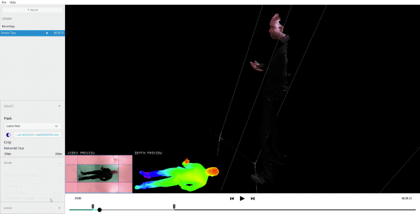

Hey all! Just playing with DepthKit properly for the first time and I’m using the Intel Realsense D435. I know this is considered experimental, but so far everything is dandy except for the fact that my data stream has a lot of holes in it. The default RealSense software lets me fill the holes, but I don’t see that option for DepthKit. Any tips? Thanks!

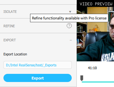

ibrews Alex Coulombe #4
Ah! Didn’t see that since it’s only in the Pro license option: image
jillianmorrow jillian morrow Staff #5
Hey Alex! You can upgrade at any time and still enhance your existing footage!
