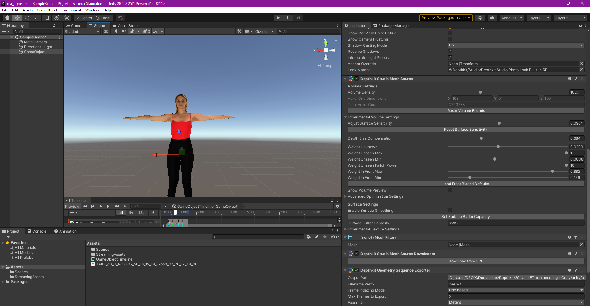

@PatriceLaCroix Hi, can you share screenshots of
  • your asset as it appears pre-export in Unity
  • The reconstruction settings, particularly volume density, in the Depthkit Studio Mesh Source Component?
  • The exported mesh in another 3D tool like Meshlab
@PatriceLaCroix Thanks for sharing. I see a couple things you can adjust:
  • Volume Density is set to 102.1 - For the Mesh Export Workflow, we recommend a density of 175-200, which will reduce the size of each voxel (and also increase the file size of each mesh). Be sure to set the surface buffer capacity after adjusting.
  • Surface Smoothing is disabled. We recommend enabling it, and adding a small amount (~0.3 - 0.5) to smooth out some of the depth noise and get rid of tiny geometry islands, but not so much that if flattens details like noses and fingers.
  • It’s tough to tell from the Unity screenshot, but you may be able to get back some details like fingertips by making small adjustments to the Surface Sensitivity and Weight Unknown/Unseen tools, especially after having applied Surface Smoothing.
  • When making these adjustments in Unity, change the Scene View Mode (in the top left of the Scene panel) from shaded to Wireframe or Shaded Wireframe to preview the size of the faces/triangles of the exported mesh as you adjust.

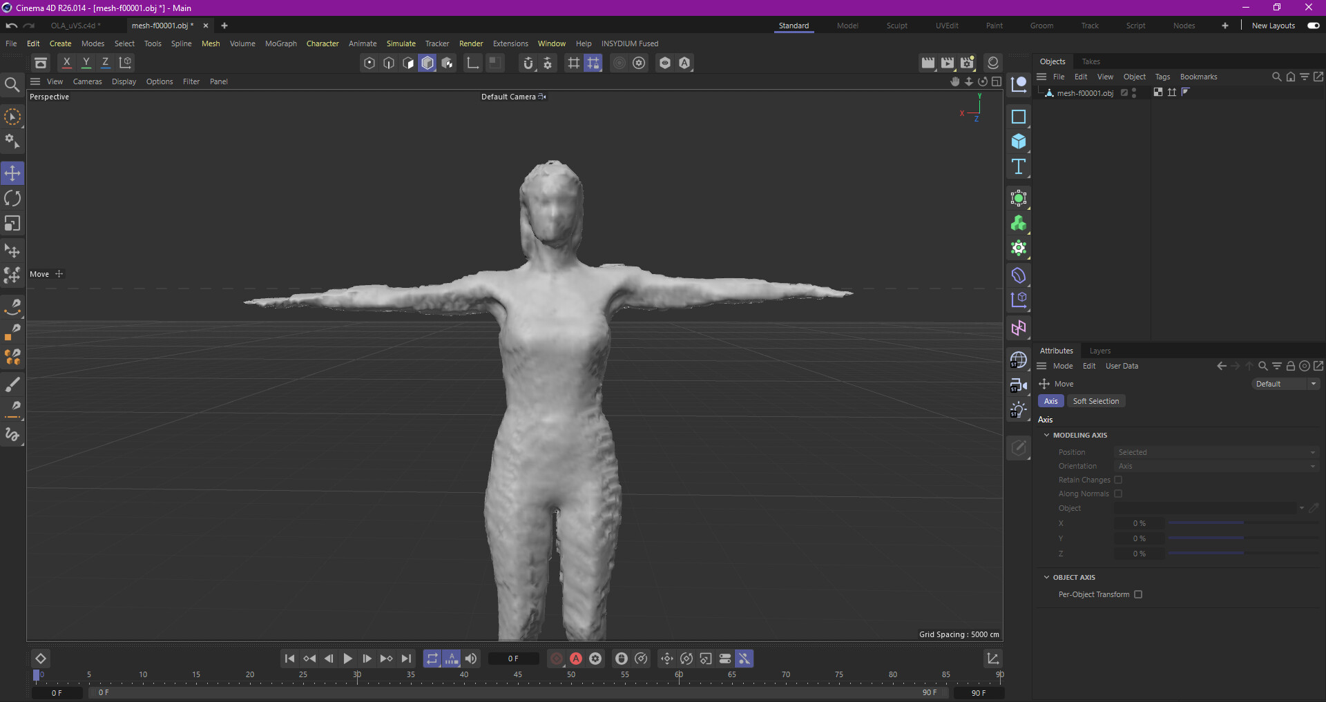

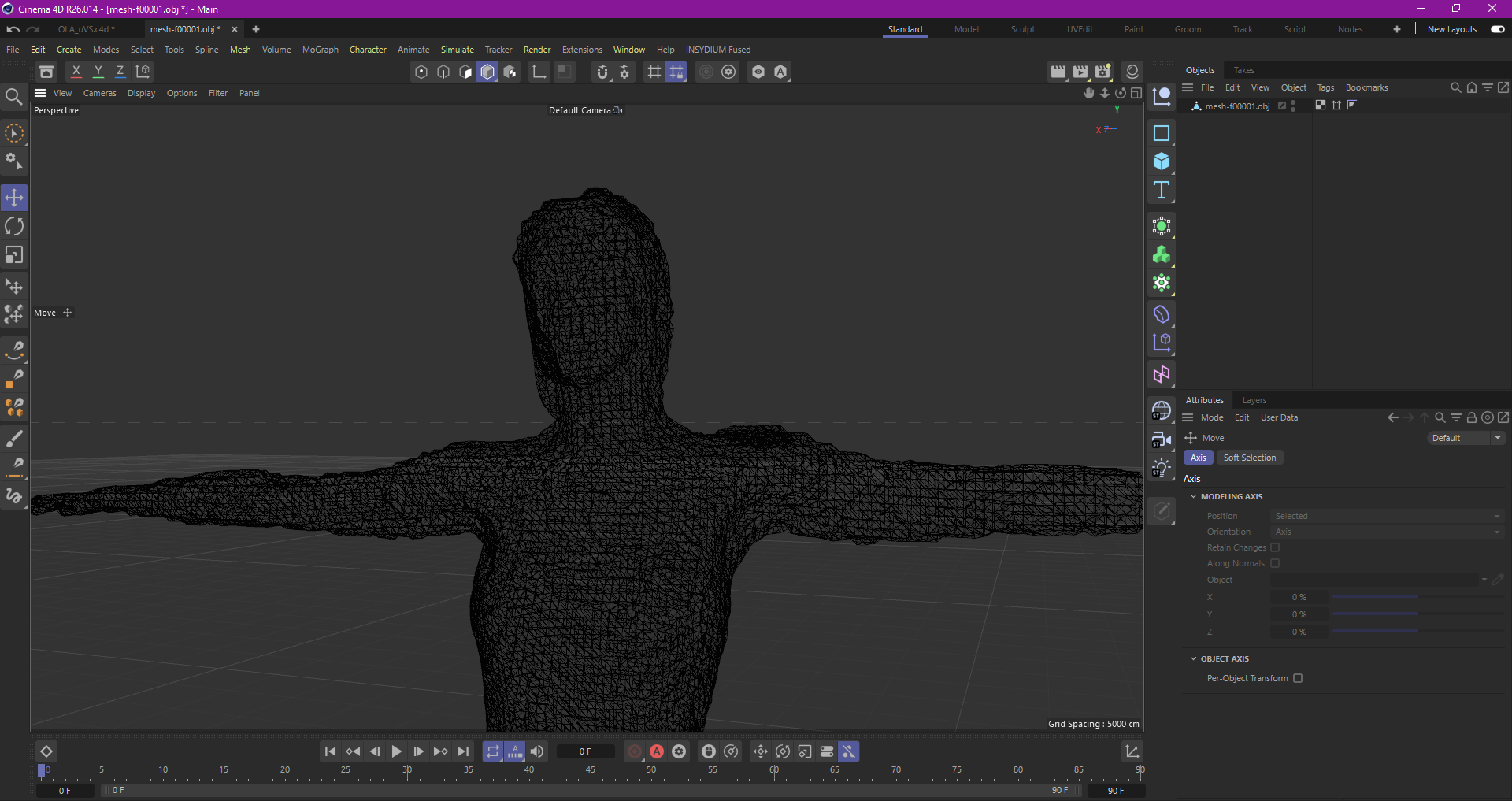

I followed your recommendations, and now our mesh is at 10mb, which is better but still very low quality…?
