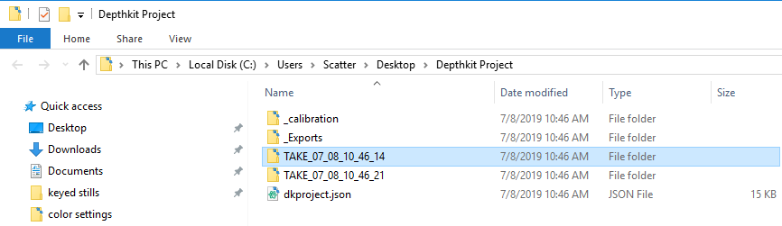

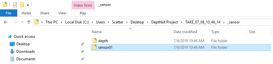

You can find the RGB sensor video in your Depthkit project located in your take folder as seen below:
Once you’ve identified the take you want to work on, the RGB sensor video is under Project\TAKE_07_08_10_46_14_sensor\sensor01 as pictured below.
