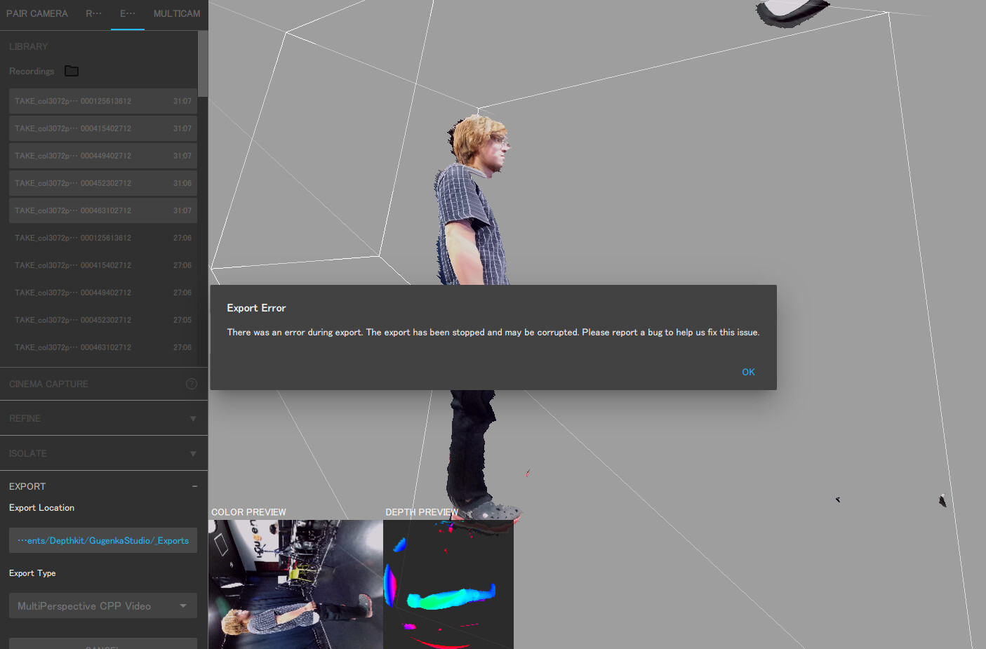

Hi, @KiralPoon. This is often the result of Depthkit attempting to encode a video with a resolution greater than what is supported by the codec. What is the resolution of the resulting Multi-Perspective CPP Image Sequence? It looks like you are using the Azure Kinect’s WFOV Depth Mode - Is this the 1024x1024 WFOV Raw (15Hz) mode? Do you have Refinement enabled for any of the sensors?
For the best quality, we recommend exporting your asset as Multi-Perspective CPP Image Sequence, and then encoding the image sequence into a video using FFMPEG, as described in our encoding guide. This allows you to control bitrate and colorspace options, which helps avoid compression artifacts and color/geometry distortions during reconstruction.

I think our team already solve the problem by adjusting the camera mode. If I encouter this problem again, I would be happy to share.
