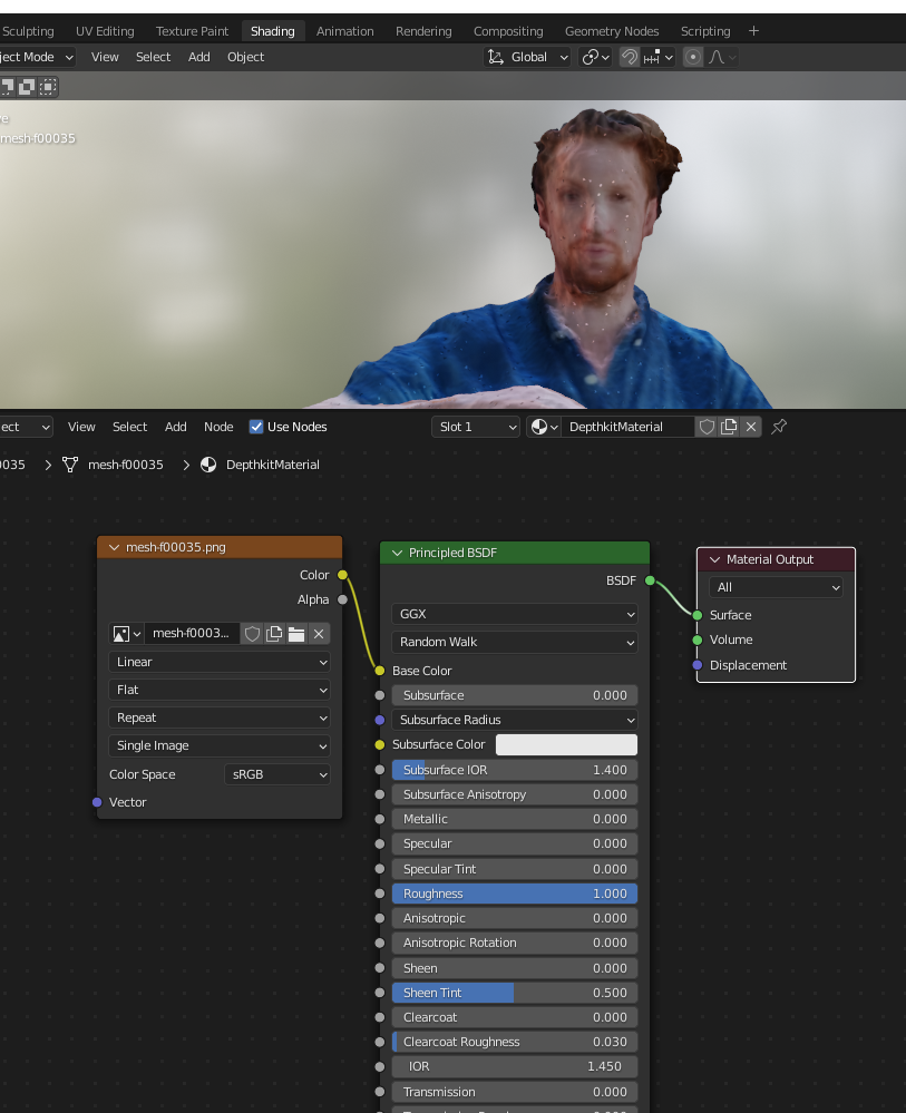

MartnD Martn D #6
I scaled the texture factor 3 down (5760x3702),
but still nothing shows up at meshlab ? or windows 3D viewer …
strange !!
In the viewport of the EVE record programm I see an super tiny result and I have to zoom in like crazy to see the full body OBJ … this viewport and the entire EVE programm is writen with UNITY …?
and in Blender I got now a result ? … but meshlab doesnt show anything ?
and blender shows a result what is not really how I thought it would come out … ?
I guess blender dont know how to handle the texture file …
for the screenshot in blender I exported another biggest version as the smaler ones long even worth ☹️
Greetinsg martn

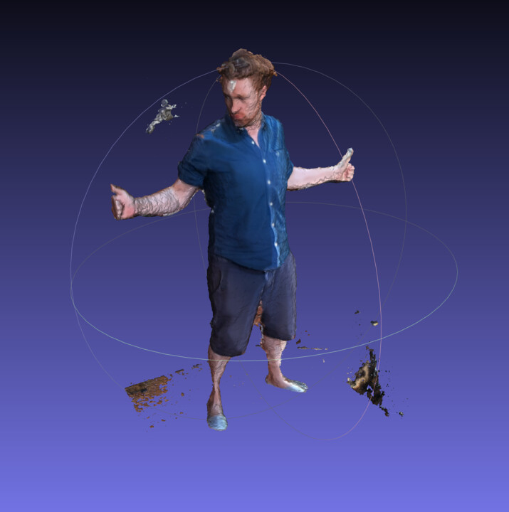

@MartnD Our team looked at the OBJ you provided, and found that the OBJ is written with commas instead of periods, which is likely why it isn’t opening in some applications.
If we replace all of the commas in the OBJ with periods, it does open successfully:
This may have something to do with the localization settings of your computer, and we’re looking further into it, and will keep you posted.
