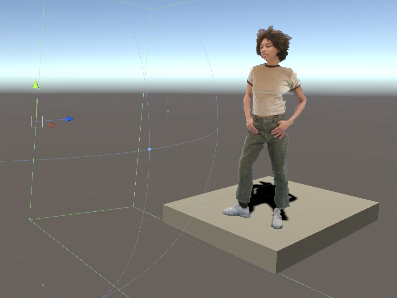

Can anyone advise what the origin point is for a model brought into Unity. Is 0,0,0 the Kinect camera always or some other point in front of the subject?
Thanks
Dan
Hey @DanMills! The default origin is the location of the sensor position seen in the demo clip below.

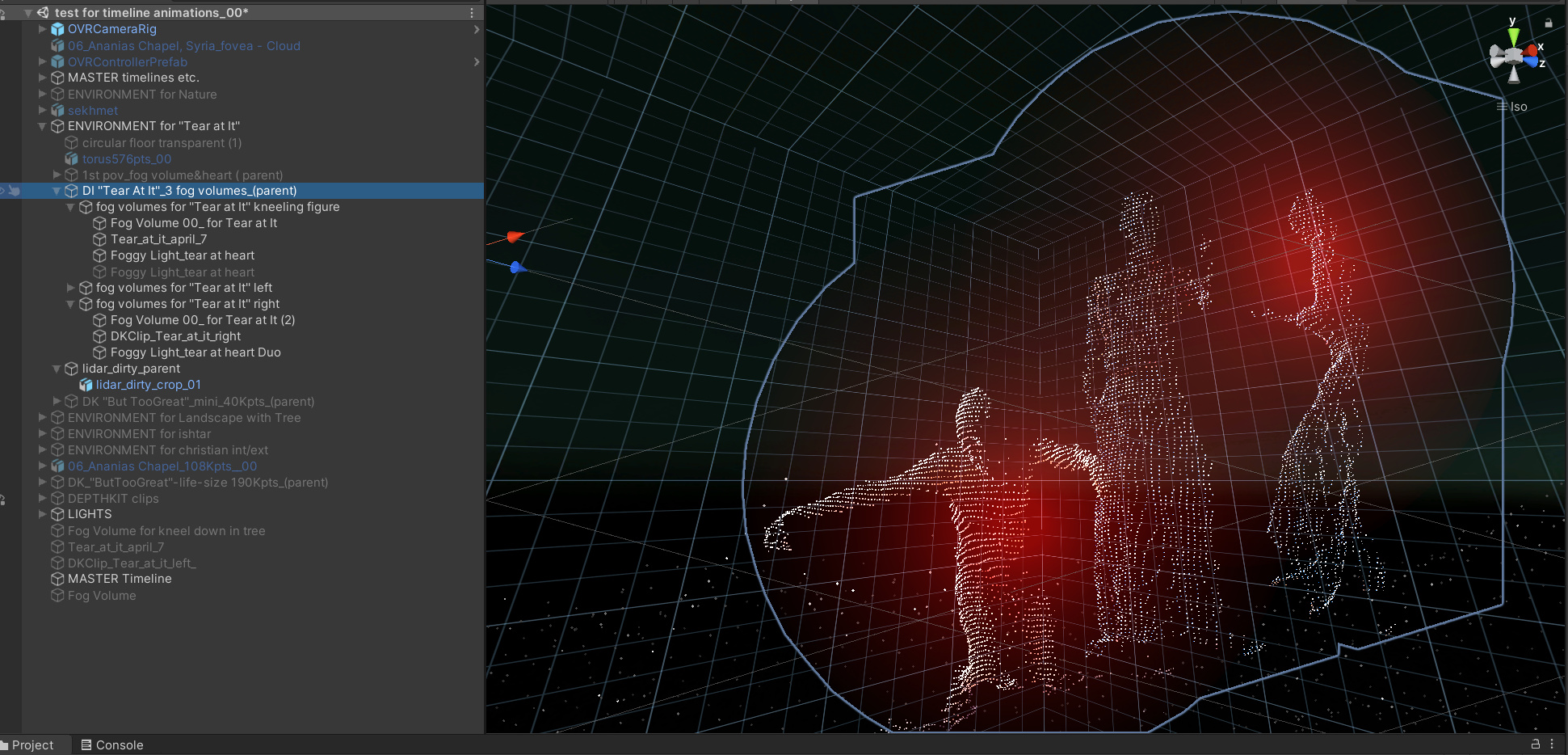

NickVenden Nick Venden #5
Three DepthKit clips’ parent (empty object) bound to a timeline object. The three blue animation clips (center) are controlling the opacity of the points in a Zero Days Look Point Layer.
Have fun!
