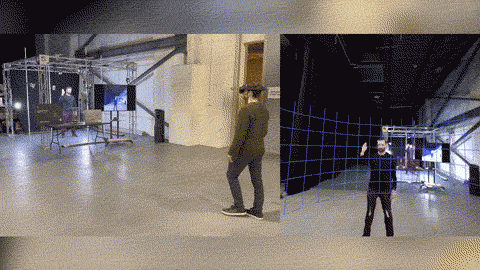

I got passthrough working with Quest 2 (obviously a bit low grade due to black and white/grainy cameras)
Hi, @MartnD
QuestProMRDemoLQ
We haven’t tested ourselves on any Pico devices, but we have been able to build APK’s that run untethered on the Meta Quest 2 and Quest Pro (see above GIF). Because of Android-powered XR device hardware constraints, we recommend constraining the Depthkit asset to 2048x2048 video, and using the Depthkit Studio Lite renderer to make the build more performant.
Setting up passthrough for Quest builds is relatively straightforward, and in our experience, the refresh rate of the passthrough layer seems to be uncoupled from Unity scene framerate, ensuring that the passthrough layer is always silky-smooth.
