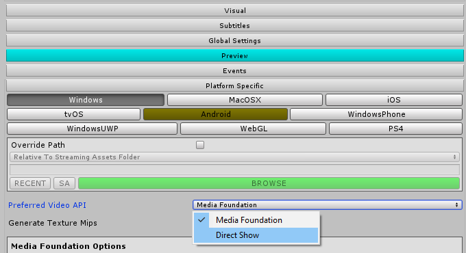

  • Now import the HAP video files into your Unity Streaming Assets folder for playback. You will also need to set you preferred video API to Direct Show.
DirectShow
